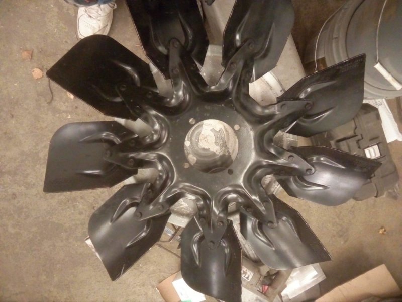

6.5L 9 blade fans

Redrill? oh you mean the fan bolt pattern for the clutch. maybe, if it fits on the old style clutch centered I could redrill for the 6 bolt pattern. what is the inside diameter hole measurement? I'll measure mine and also see if there is some centering tabs on it. ultimately I will need to convert to the newer style pump, at least that is what i'm planning on doing when my current pump decides to fail.

Hmm.. I just looked up by application for a 97 model clutch and see that the photo on AAP shows a 4 bolt clutch with the 4 bolt fan pattern. mine has the 6 bolt pattern for the fan to clutch. I wonder if this will work just by ordering this type of clutch?
Here's the clutch on mine...
Yes. Order one from a 1997 and it will work with the low output or high output 4 bolt pump.
