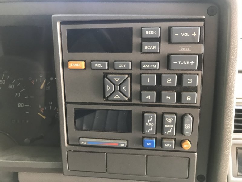

The bar graph for cold/ hot blend door had issue from the sunlight fading them in some cases. The control would still work but display could be hard to see. I believe that design is pretty reliable.
The two dial control that followed and the two dial with a round push button between them have a higher failure rate on the fan speed switch itself. Not enough I would avoid it though. It is a far more convenient control imo. Holding your finger on the bar shaped button of the older one seems to take for ever to go from cold to hot rather than quick turn of the dial on the new one.

I've got both my only complaint with the older dash is the heater control can be finicky. Trying to get the control to stop in the right spot can be a challenge to get use to. Other than that they are just different. Ones my plow truck the other is my DD so I don't expect them to be the same.
Call me old fashioned but I prefer the early dash controls, never had any complaints with mine knock on wood..

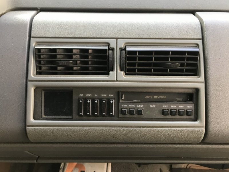

I did remove the radio and put a single din under the center ac vents and put a cubby hole in where the stock radio was...
Oh, and I put blue led bulbs in everything, even the havc controls... lot easier on the eyes at night...
I would keep the 1994 dash. 1995+ was redesigned for airbag(s). Speakers go in the door on 1995. Dash for 1994 on down.
I only killed one HVAC for 1992 when the batteries failed. The 1995+ controls are pure Krap IMO for reliability.
The 1995+ dashes like to break out around the bolt holes esp. on a dual rear wheel truck.
Put a storage area in for the OEM head unit and 1 din aftermarket radio in like everyone else does.
A trip to the junkyard and pull some head units and amps out of gas rigs. Pay attention to the controls on the head unit and keep them matched up with the amps. Some have equalizer buttons and some don't. A lesser known 3rd option is a casette deck or full equilizer in the location where most slam the 1 DIN aftermarket radio. You will need the wireing for the EQ if you find one. The dash lamps burning out in the head units were my main problem. I used a XM radio via FM modulation with the external antenna unplugged.

Thanks for the feedback guys! Reading Will and AK’s responses were reinforcing my thoughts to do a swap because the newer controls are more handy to use......and I was also thinking about how it’s nice that the passenger can reach the controls if wanted.
Then I read WW and TSP’s responses.....hmmm maybe the 94 isn’t so bad after all? And mine is in really nice shape. My 97 Tahoe’s dash had the typical cracks on the top and that sucks. I also had fan speed problems but getting rid of the plug behind the glove box fixed that. Put a nice single DIN radio in it and some nice mechanical oil pressure and water temp gauges where the radio was would be a nice upgrade. Here are pics of the 94 dash. I couldn’t get pics of the Tahoe’s dash due to its current state. Looks like my 94 has the rare cassette/EQ option WW was referring to. It still has the tape for it in the glove box, too. Too bad it isn’t making any sound right now.

X2 on the newer controls going bad on the later models... I have a 94 and a 96. I just put an aftermarket radio in my 94 so I could play CD's and have a USB input.... The thing I really don't like about that is how far over I have to reach to change the volume or tune it. In the later model dash the aftermarket radios fit up close where they are easy to reach. Aside from that I think the older dashes are a little more durable.
The newer style hvac controls fail primarily because of power supply issues. I've had the same control head in my 95 for about 12 years. The last one that got replaced ended up being the burnt infamous ground wire that was a 95 issue. And you can repair these control heads to repair the part that burns up in them with a relay(and install a better resistor to tepair the heater control valve circuit). The airbags didn't come into play in the dash until 97 as 95/96 only had the airbag in the steering wheel. I have both and there's no way I could DD one with a 88-94 dash. The 95/96 is my favorite dash of all of them.
That dash is in outstanding condition vs. the cracked stuff I see here. Fix the rare OEM radio. It just has a clean look. Aftermarket radios have small buttons you can't see or use with gloves on at 75 MPH. (I wear gloves for pot holders in our heat...) Maybe the speakers have all rotted out. Last time I pulled head units and the main amp by the throttle pedal it was like $35. at a junkyard. Main amp IC failure is common as well as cracked solder joints.

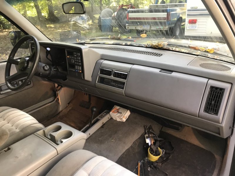

I just bought A 93 K2500. That's a dash it's trashed, I have a donor truck. It's a 95, with a perfect dash and instrument cluster. What kind of wiring issues did you run into with swapping over your instrument cluster?

The only reason why I'm doing it is the the dash is trashed The truck has been abandoned for 10 years, and rats have been living in it and it's horrible smelling. I'm afraid I will never be able to get that smell out of that dash or the door panels or the seats or anything
I have a donor truck with perfect door panels and a dashboard. My only concern is the instrument cluster and the heater controls. Won't be wired the same. So I was trying to find out from the Original post. You're what kind of issues he ran into with the wiring. I can't swap over the whole wiring harnessing computer. 1's a 2 wheel drive half ton. The other 1's a 4 will drive 3/4, different transmissions, etc.
Yeah, you can't really do just the dash harness, you have to do the underhood stuff as well because they changed how the harness routes between the 2 generations. The dash would be easy to clean once it's removed, but not sure you could clean the rest of it well enough to get the smell out.
