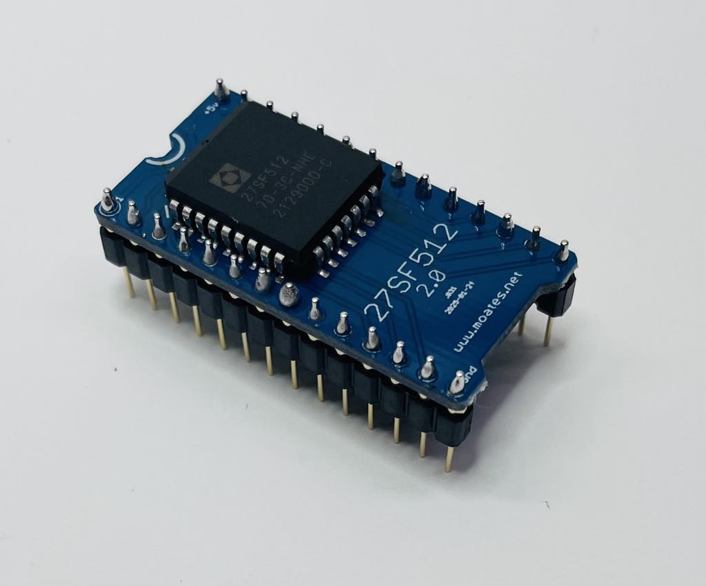

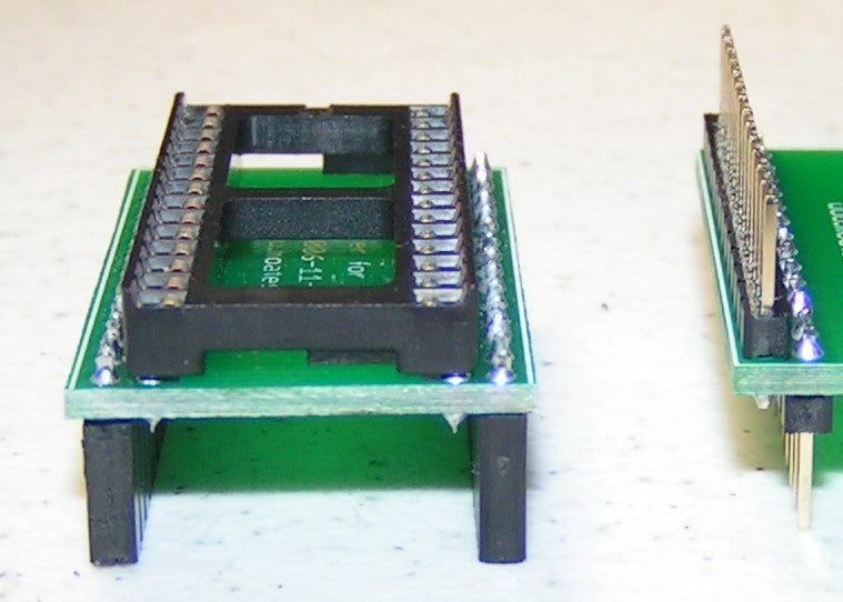

if this is the case and since your rig is a 95 (obd1) with an automatic trans, if we can find the components online (chip and adapter) I can program you a chip to replace your existing one inside the PCM that would keep the GP's running for a little longer. Free to program the chip, just need to find one since Moates has gone out of business and no longer selling the eprom chips or adapters. I have all the equipment to do the programming.
Oh Wow!! I just looked up and see Moates is back!!! the guy had retired and shut his business down sometime around or after Covid had hit. i just looked and he's back!!
Here are the two items you need for me to program you a chip to extend your GP time.
the adapter to connect the chip
and the chip you need.
