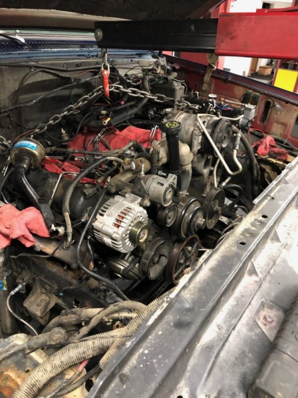

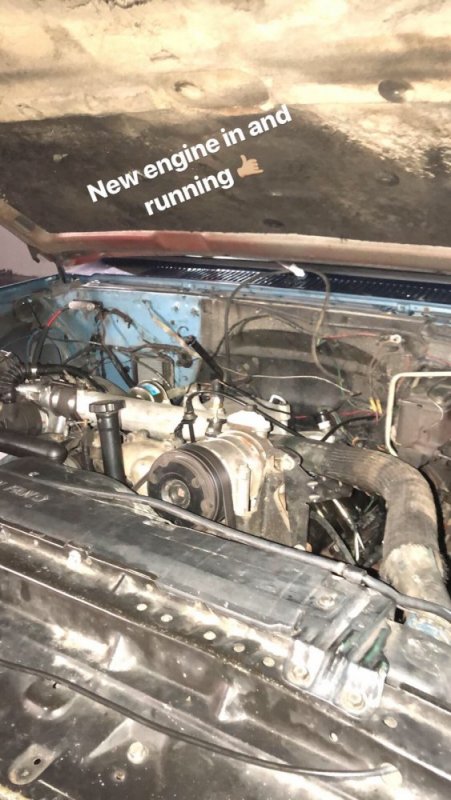

Just finished up the swap today. My son started pulling the 6.2 Thurs and we finally finished it up today. He ended up buying new 93 Injector lines, a 4911 pump from Pensacola diesel, oil cooler setup from Leroy diesel, polyurethane engine mounts, and a few other things. We did have to make a throttle linkage bracket because the dual thermostats hit stock linkage. Used everything from the 2001 6.5 except for the flex plate. Runs great. So smooth and and definitely more power than the 6.2 W/turbo. So glad to get rid of v belts. Next is to retrofit the HVAC from GMT400 body style to make his A/C work

Nice! Did you remember the restrictor fitting between the thermostat housing and the waterpump?

Thanks. No. No restrictor fitting. Just ran it the way it came. I'll get some pics tomorrow of the throttle bracket. I didn't take any pics. and he only took the 2 I posted. He's pretty excited about doing all this and he comes home tonight all amped up about how much smoother and better the Blazer runs and drives and my wife says "oh boy, that's you 25 years ago when I met you".

On the restrictor fitting, remember the original design had one, and the fitting mfr supplying AC Delco went under and that is why the original design stopped was over lawsuit concearn. Bunches of folks that seen the difference themselves by adding it. Leroy makes the wazoo version, or diy one. If diy, you want 1/2” thick material and 3/8” hole. It should be mounted in the waterpump not the thermostat housing.
