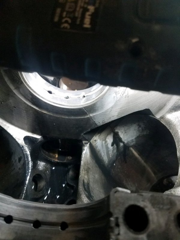

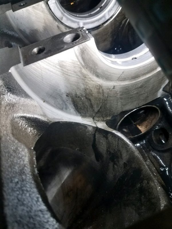

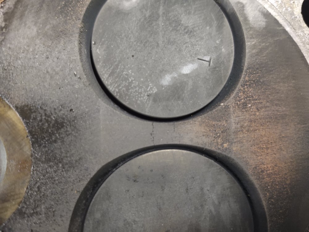

Because there is a coolant passage between the valve openings in the head to help keep the seat area between the valves cool. When the head cracks between the valves, it cracks into that coolant passage. Thus when running, the compression leaks into the cooling system because compression presure is well past 400psi while cooling system pressure is 15psi. After shutdown, the hot, pressurized coolant seeps through the cracks and into those depressurized cylinders and gives you the white, billowing, acrid-sweet smelling clouds out the tailpipe at cold start up that screams "blown head gasket or cracked heads".Umm school me here, I’m confused how cracks between valves caused compression leaking into coolant..?

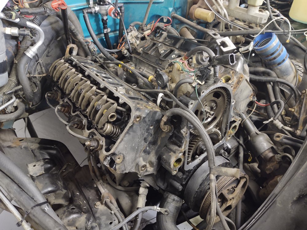

Well, two options. New heads or the brass tube inserts into the coolant passages. Assuming the heads aren't too warped.Noticed a small stream of bubbles in the expansion tank. Tore it down this week and SURPRISE, four matching cracks in the head! Can't wait to pull the other side!
