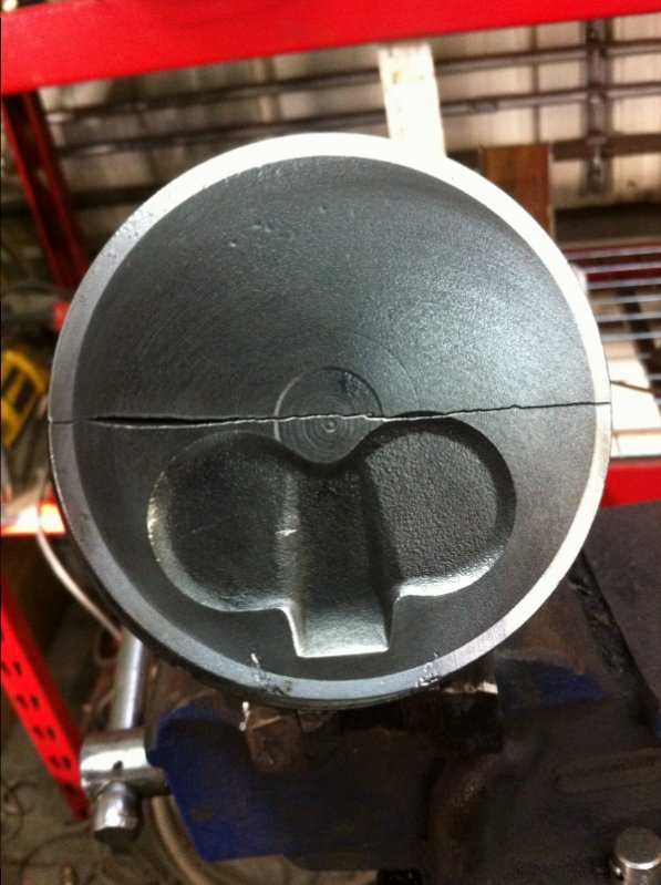

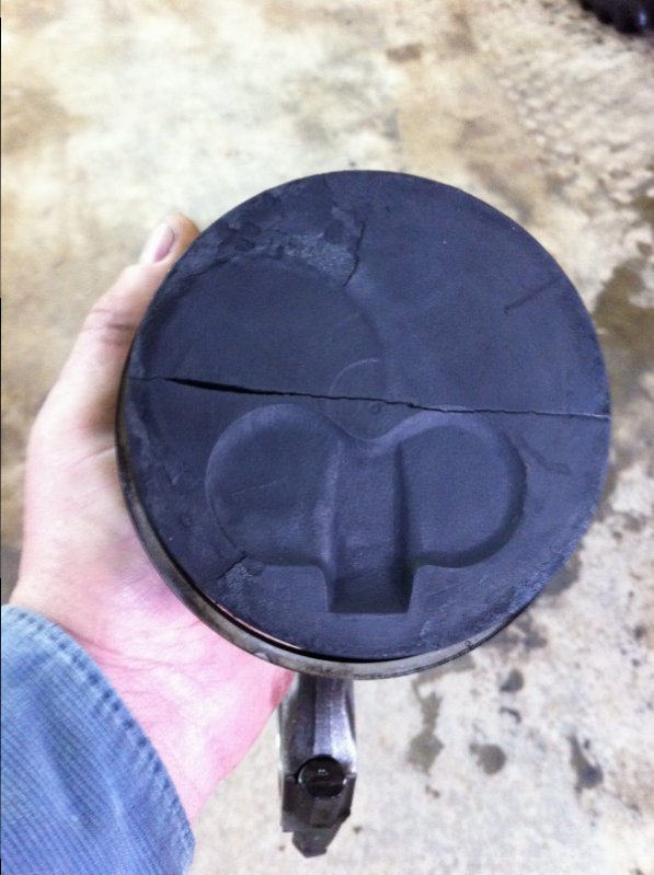

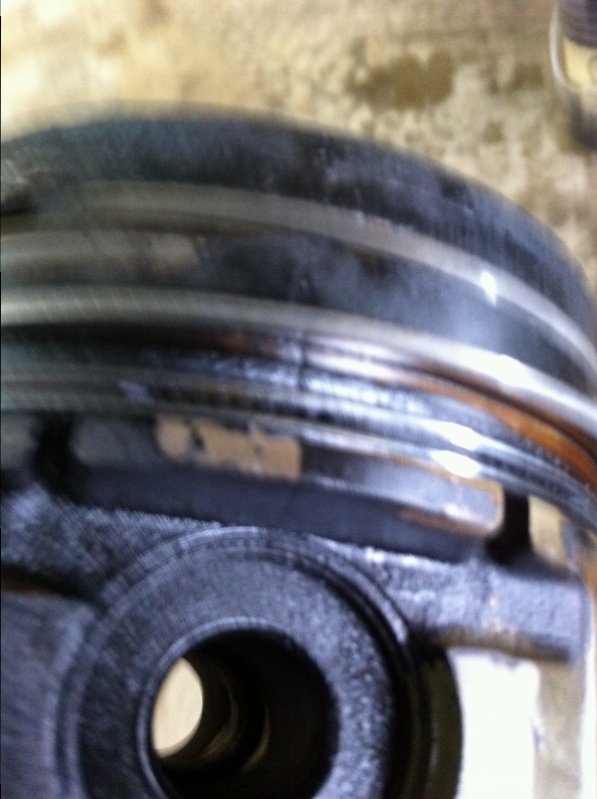

I think more of a week spot causing fatigue in that piston,. or maybe a bad casting.
Well with 415k kms, or 260k miles for our southern neighbors, and Les. That ain't too bad, it would be in the 8000 hr range.
