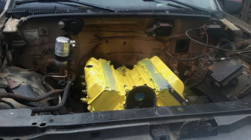

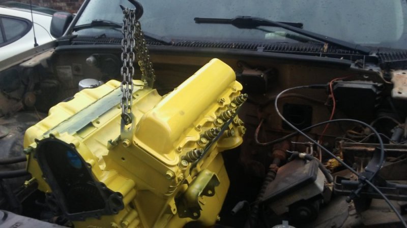

20170522_193225.jpg 20170522_195557.jpg Got the engine mounted in the tahoe. Waiting on a none rainy day to get the tranny in place. Have an IP getting rebuilt, so things are coming together. I would like to pull as many wires as I can that will no longer be used without messing up the ABS or AC...etc... where is a good source for wiring diagrams? I have the haynes and chilton manuals but those diagrams are a little to basic and leave a lot out. Also I still have a good bit to learn on how to make the tach and speedometer work. From talking to the guy at US Shift the Quick 4 transmission controller can send a speed signal to the computer which will in turn drive the gauge...but I am not sure if I need to use the computer out of the donor diesel truck (4l80e transmission) or if the tahoe's gas computer which used to talk to the 4l60e trans will work.
Possibly a little late, but . . .
IIRC for the dash cluster: the tach gets its signal from the alternator, the speedo gets signal from a port on the VSSB, and the ECT gets signal from a sending unit above the #1 cylinder in the head.
The PCM gets speed from a separate port on the VSSB and ECT from a sending unit on the thermostat crossover. Not sure how the PCM gets RPM signal, but do know that it does.
Do not know about how the dash cluster gets voltage or oil pressure signals, but from what I had seen of wiring diagrams, do not recall outputs for signals from the PCM back to the dash cluster.
Aside, now is a good time to install a third ECT sending unit (and at least a set of wires for future attachment to a second gauge) in the head above #8. Reasoning is that trying this later is a pain due to clearance and the benefits are that you have a backup sensor when one of the other two fail. It is not a big deal if the sending unit above #1 fails as that only goes to the dash gauge. If the ECT sending unit in the thermostat crossover fails, it will mess with fuel injection timing and the transmission's shifting.
If you can find the budget for an external gauge cluster, consider connecting it to the OBD-II port. As an example, I rarely look at the dash anymore and just read from the Edge as it gives me correct speed and ECT where the dash does not. Add in auxiliary sending units for fuel and boost pressure, and the Edge can turn into a rather complete view of the motor all in one compact space.
That is one route that I am contemplating.......... just making my own instrument cluster. The hard part about that is making it look sharp... The hard part about keeping the original cluster is sorting out all the wiring.
With an Edge, you do not need to sort out how to wire-up a new instrument cluster as it get inputs from the PCM and any auxiliary sending units that you install (like boost and pyro).
Or look into a tablet and some other software that reads from the PCM.
There are still wires to sort out because I am replacing a 5.7 gas engine with a 6.2 diesel so the sensors used will be different. (at least for the RPM) Coolant temp, and oil pressure might be similar enough......then there will be many sensors/wires that I no longer need, and I would like to cut out as many of those wires as possible. Just a little hesitant to start hacking wires without a firm knowledge of what I am hacking.
