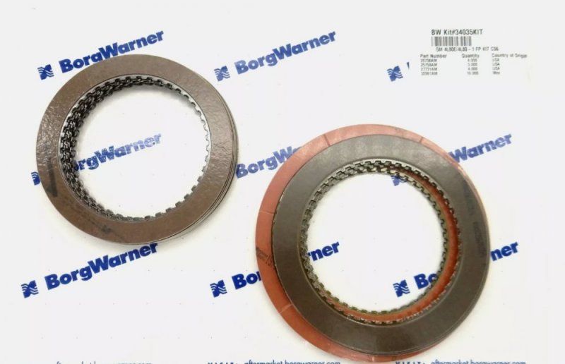

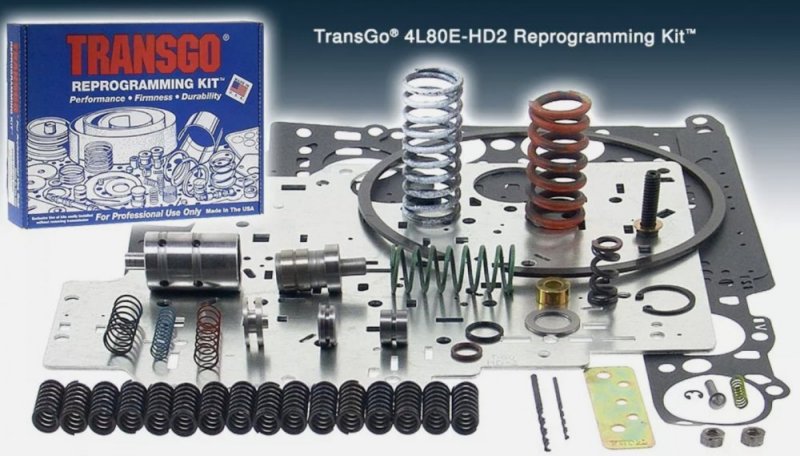

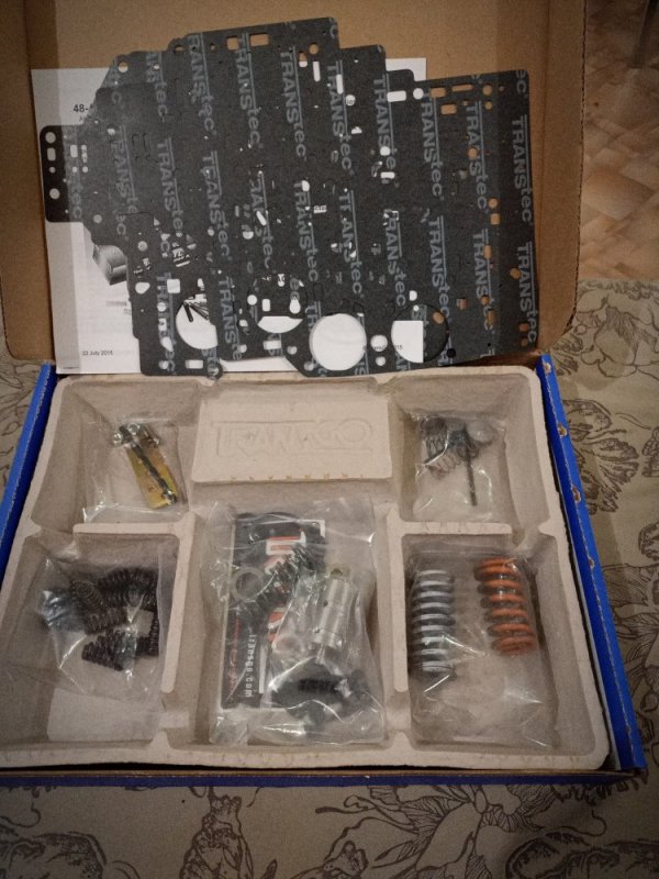

Ordered all new valves. a set of clutches, a set of gaskets and rubber bands. new pistons in drums. what else need? Ebay sells many kits of obscure sonax and transgo,. which of them will you advise?
Screenshot_2021-01-10-07-18-52-41.jpgScreenshot_2021-01-10-07-18-29-62.jpgScreenshot_2021-01-10-07-17-35-78.jpg
I used Sonnax and TransGo combined, Sonnax is more into fixing factory issues for reliability, TransGo is for more pressure and performance. Then there are Billet parts for more strength which can easily dent your budget.
Can immediately buy a kit 34200-16k?
I don't like the sonnax kit, the transgo kit is preferred by most builders. It costs alot less, the single valve kit is under $60, but you have to buy a $315 reamer kit to put it in. The transgo kit to do 5 trannies with reamer is $105(bought mine a year and a half ago for $65, can't believe how much prices went up).
Transgo 48ACTTL
I would also put in the transgo 4l80e-tcc valve.
