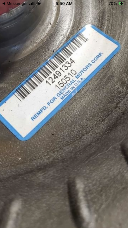

Can you enlighten me on the 4l80e converters? what years will this new converter I have for a 94 work in? Possibly a 01 6.0??

No. Input shaft spline count is different, I believe. Iirc the change came with the 2000 model year. Ferm is the transmission expert.
