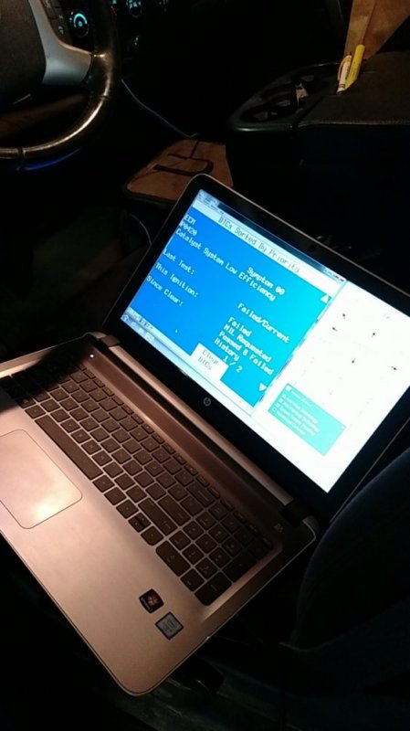

The lml goes is for its 79,710 mile emmisions crap failure issue. I think the code was 0420 (it's in the pic) but the dealer said he's never had that code, plenty of others but this is a new one.
Said new NOx sensor is first and that's almost never the issue, then the injector, then the catalyst. Figures it will be at least 6500 in warranty work.

What we typically see when you unthread the nozzle is a heavy build up of soot. That usually means the injector has gone bad. If you had a scanner, I wo look at the ohms reading on on NOx 1 & 2. It should be around 2. Ohms. If it's 6 ohms the sensor is bad. We've been paying around $275 for a #9 injector. You'll need the special fuel line removal tool. Then go drive it for about 30 minutes so the rpm is up around 2800 rpm.
