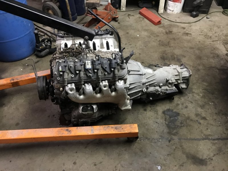

I decided since things were starting to get more serious, that I needed an LS short block for mockup purposes. There wasn't anything cheap on Marketplace so I roamed the jumkyard. I found a 6.0 in a van that someone had removed the heads off of so it was crusty.......it also had a grenaded piston. I got that and the 4L80 that was attached to it for $150. The trans will show up in another thread soon....
