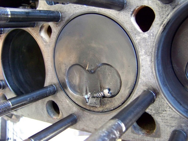

Sadly the debris in the intake doesn't stay in one hole: it bounces around in the intake and can bend several valves. I swapped both heads, and new slugs with gapless rings, after loosing a worm clamp during an IP swap. It took a week to fall apart and "show up". I had intake valves bent on both heads.

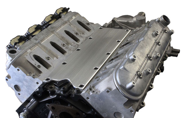

Fortunately on the LS it wasn't in the intake, it was on the valley cover and fell in the intake runner on the head. So kept the parts in one cylinder at any rate.

One of the few things I learned in an automotive class by an old GM mechanic who was teaching it: Debris in the intake doesn't follow airflow. The valves and pistons are moving very fast. This speed can smack the debris and bounce it out of the head port (even clean out of the cylinder) into the intake or another head intake port. Vibration and airflow can move it into another intake port from the intake.

The picture above with the worm clamp screw: the clamp itself was in another intake port.
The above said the minimum needed is to do a compression check on the other head that wasn't removed. Maybe you got lucky: Vegas Odds say you didn't.
