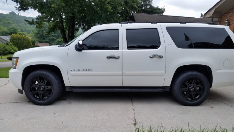

Very nice addition, the black wheels are a plus against the body color white.
Nice vehicle with lots of room, the 5.3L is just fine for family hauling, still plenty fast enough to get you hurt. :eek:
Yours is a nice Suburban, I never drove one that I can remember, but I know how fast a 5.3L could make a Tahoe run, dang scary fast for a SUV type vehicle..…..:smuggrin:
