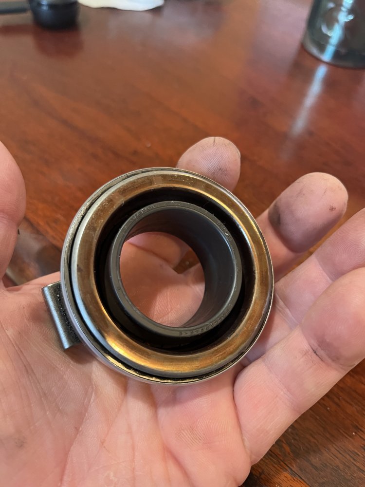

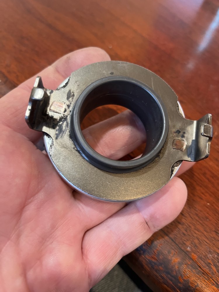

I can put that bearing in a vice and put a variable speed grinder to it to simulate it slamming into a clutch. See if the sound can overwhelm the grinder sound, but I doubt it. Really not the source of the problem. But the clutch disc was worn down to the rivets, so it was time. It is much quieter, but still…

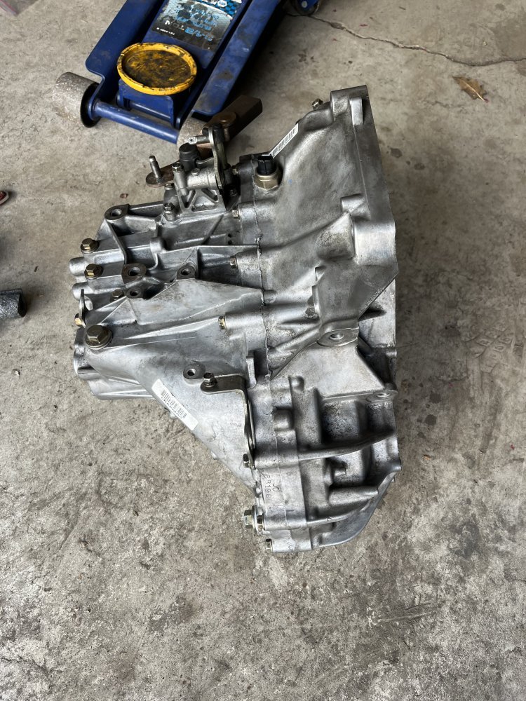

I talked to Anaheim Gear which specializes in Manual Transmissions. They said if it goes silent when the clutch is depressed while in neutral, it’s in the transmission.
$1550 to rebuild, and they don’t pull them. They only work on the repair and rebuild of the transmission. So I have to pull it and bring it to them. Time to look up that video on pulling the subframe.
On a positive note, pretty much the entire engine and transmission have been scrubbed and pressure washed clean. I am not seeing the oil leak reappear. Just this transmission issue to deal with.

Just when I thought I had to remove the subframe to pull the transmission from the bottom, I find a video on pulling the transmission from the top on a V6 Accord with 6 spd manual. I traded messages with the video creator and he says I should be able to do it on the 2.4L 4 cylinder and it should be even easier because the engine is smaller. Basically same approach as last time, but need to remove additional cooling lines and harness up top. This can be done without a lift. I do have an engine hoist. 90% I’ve already done, so I get the benefit of the learning curve. I should be able to pull this in 5 to 6 hours.

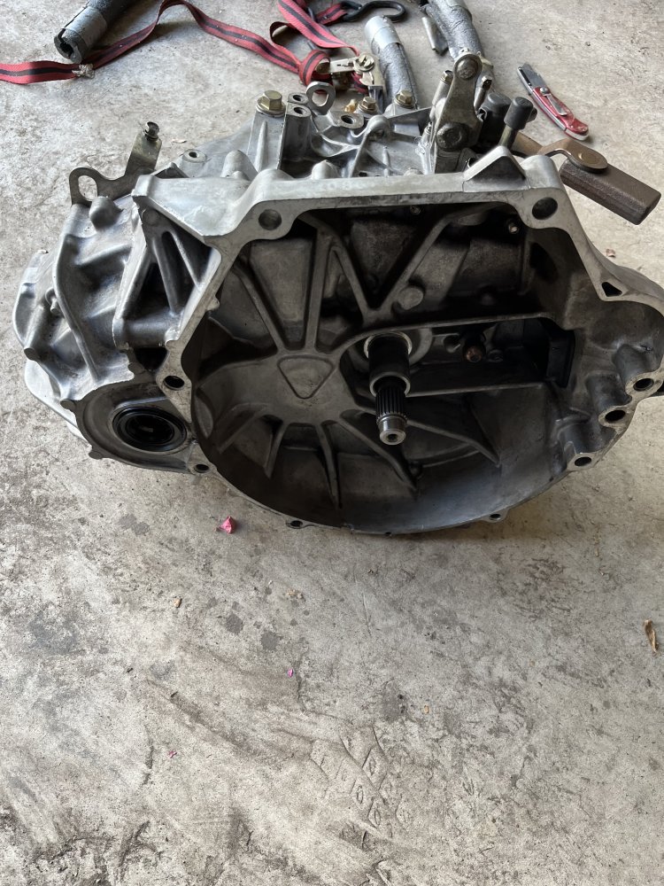

Transmission shop called and one bearing was shot and the others were on their way. All the gears are fine, so it’s a good rebuildable unit. May be done by end of the week.
This had nothing to do with the throw out bearing.

The throw out bearing is commonly toasted when the input bearing is gone.
Figure that input shaft starts with free play and the throw out bearing is only ridding in contact occasionally.
You mentioned being much wuieter & showed in the video that it was definitely quieter after the new throw out bearing. So don’t take it that bearing was good and the trans one was the only problem.
Having fixed that and then having some noise remaining to then find the input bearing isn’t surprising but does suck to pull things apart twice.

Picked up the transmission yesterday. $1250 plus $100 tax for Newscum.
Replaced all the bearings and seals, gears were fine. Asked what happened and they said just age and miles (157K). I spun the input shaft before and it was sloppy and loose with some sound. Spun it afterward and it was buttery tight and silent.
