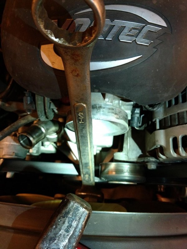

In under two years and low miles (20K tops) we are on the 3rd water pump for the 2002 Yukon 5.3L V8. OEM died, shop installed GM pump that failed in a little over a year as well as leaked everywhere including from the new GM t-stat housing. Shopped warrantied it and dropped on a parts store replacement (as GM parts warranty was up) with gray silicone instead of the metal rubber gaskets to block. It just died at 1 year leaking out the weep hole badly. Put a GM pump back on.
Missing something causing the WP failures here. Didn't see anything (debris) drained out in the coolant bucket.
At least GM didn't bolt every Fing thing to the water pump on the 5.3L. Just 4 hoses and a tensioner. Real pleasure to not have to remove all the accessories to get the pump off.
Now THIS is a Fan Clutch removal tool.
