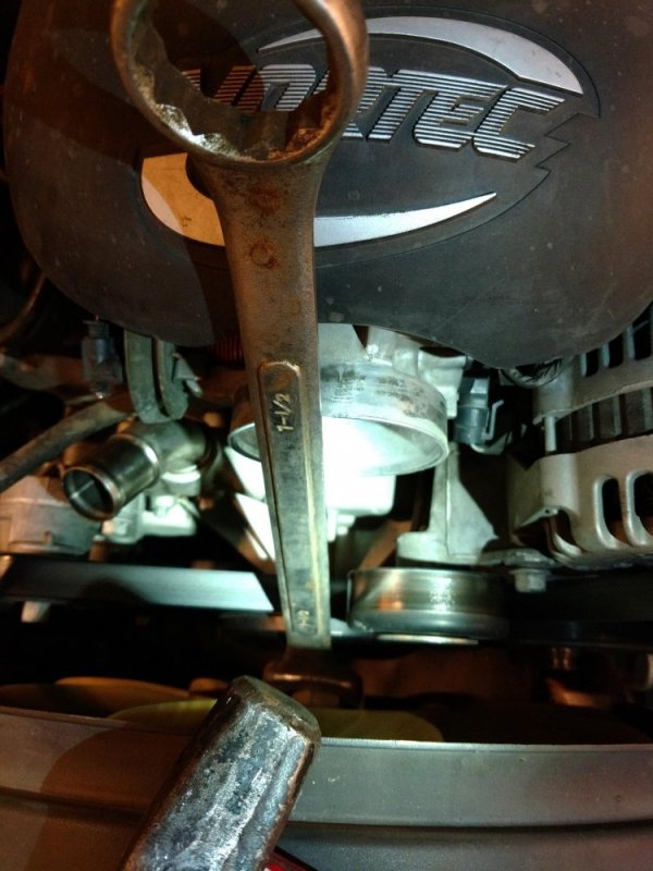

Now THIS is a Fan Clutch removal tool.
Fan balance issue- It vibrates and takes out the seal/ bearings.
Also improper load on belt tensioner can donit from a side load issue.
