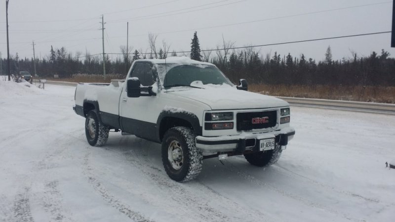

My trucks turning into a night mare 1999 k3500 reg cab long box 6.5 and a 4l80e
The truck kept throwing input sensor codes, changed the sensor fluid and filter now the real issues started, hesitates when shifted into reverse and drive. Atf is clean and full,checked all grounds they are clean. Checked the grey plug in the side of the trans conections clean and its not leaking on the inside of the conector and has a 2-3 shift code P0746 where do i go from here totally lost
