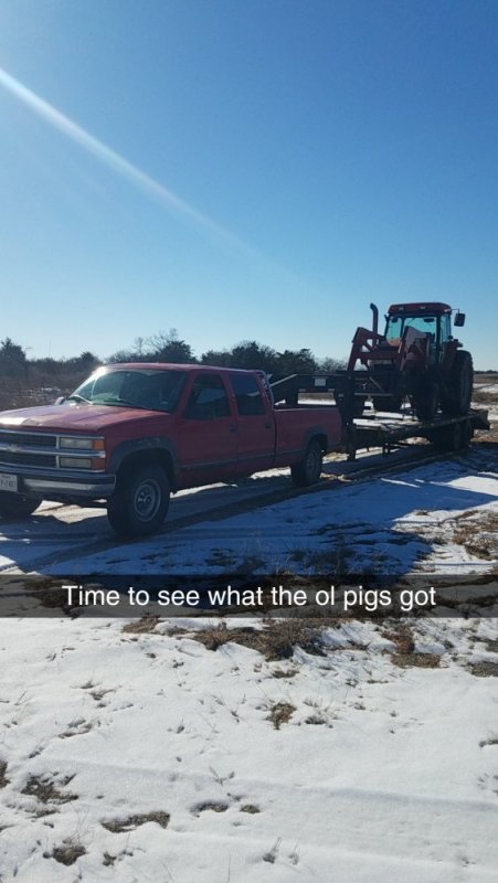

I did a few break stands before I got the sensors replaced, that test was inconclusive. After that I tried it and it would push through the breaks at 1600 then light the tires.
Today I tried it while grossing 25k.... 1800-2k so stock low stall.
