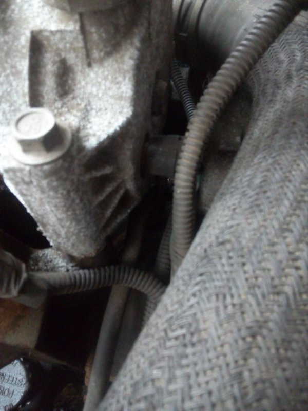

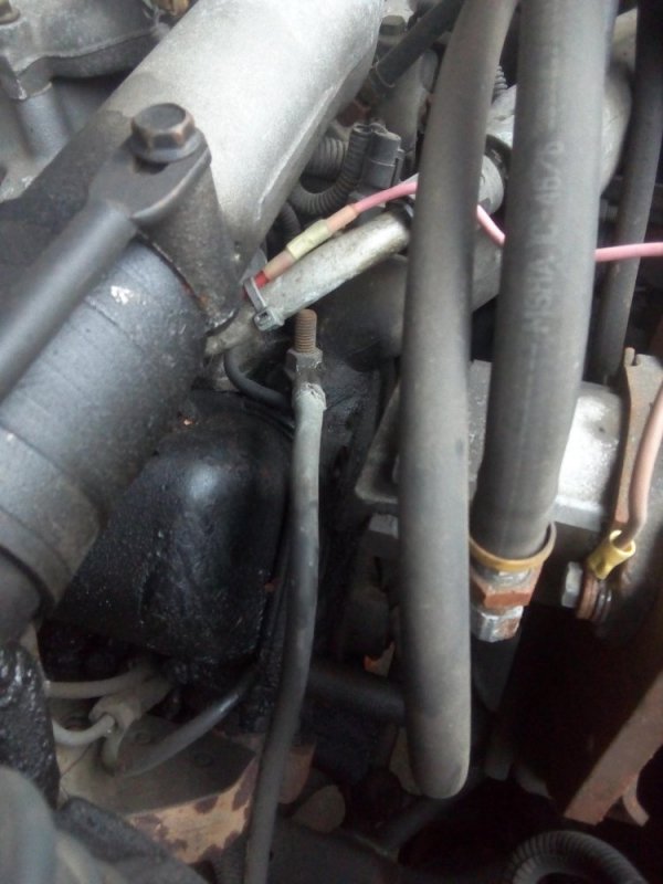

My 94 however is intake bolt which also doubles as alt bracket bolt and the passenger side goes to the coolant crossover. I'm going to be doing battery cable upgrades on the 94 so I think I'll move it to a regular intake bolt while I'm at it.IMG_20180927_183417.jpgIMG_20180927_183435.jpg
