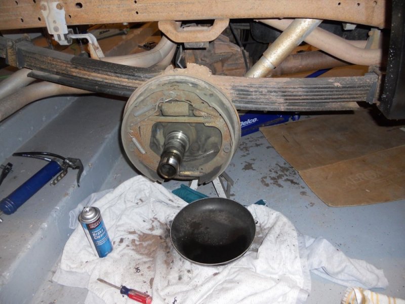

Attempt to suck in the NASCAR seat cushion - Failed: Engine just stalled out. Got an old frying pan as the emergency air stop ready.

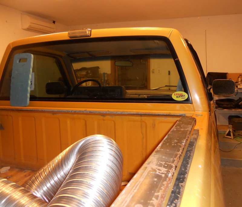

So we got it smoking. Governor check passed and nothing Cumapart... :D The initial mist was more Power Service Diesel Kleen than Diesel...The exhaust hose was a complete waste as this fired up with No Drama. (Last time after I replaced a blown engine it was raining soot and filled the shop with white smoke before it was firing on all 8. Took two days to clean the shop up... )

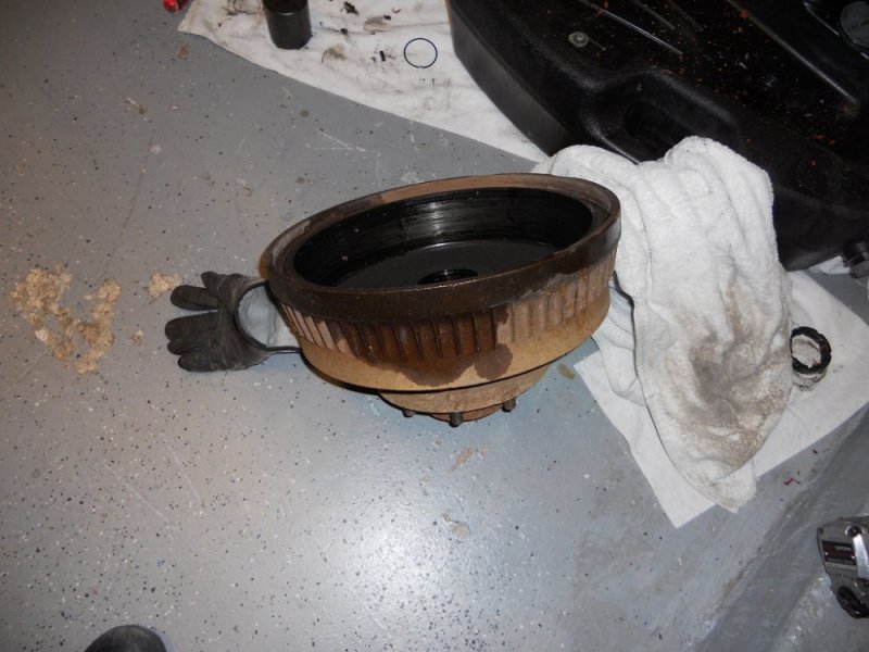

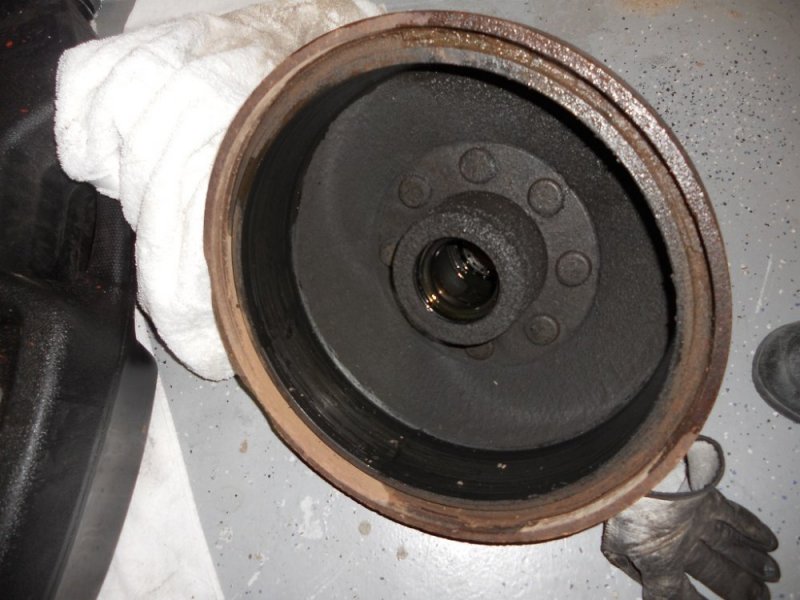

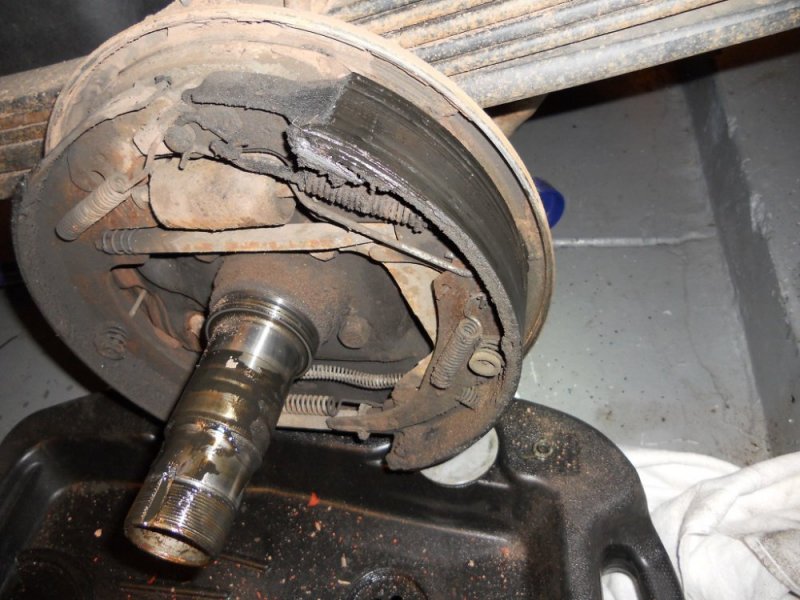

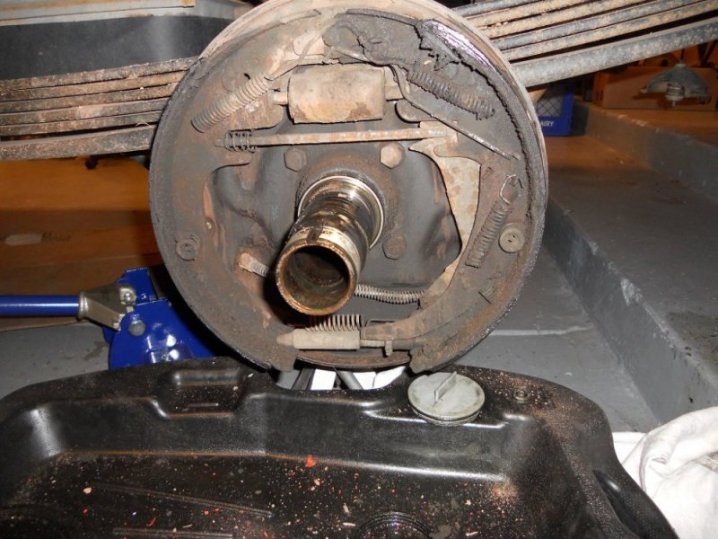

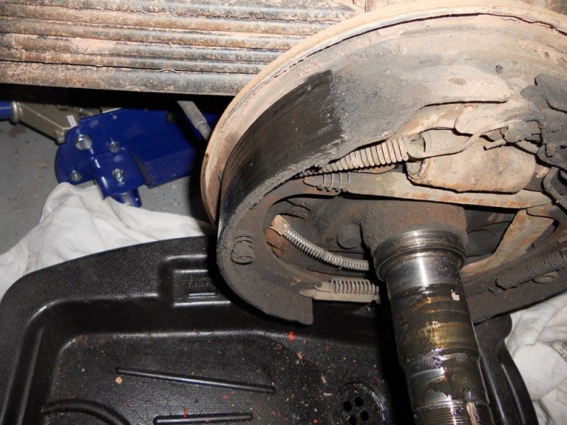

The oil leak from the brake drum is a concern!
No, I upgrade the concern to a full Problem! Pretty sure these brakes are supposed to be "dry" not wet frictions.
And this pic is so I know how the driver side goes back together. Thicker and longer shoe to the rear.
Yeah, no saving the shoes. :dead:
Assembly tip: Add some grease to the bearings. This lubes them until they get oil. Otherwise (not recommended) park with the serviced side low so oil flows to it. The bearings will burn up if you drive without doing either. You have to turn around if you do both sides and park for an hour or so.

1) Major passenger side drum shoes and seal.

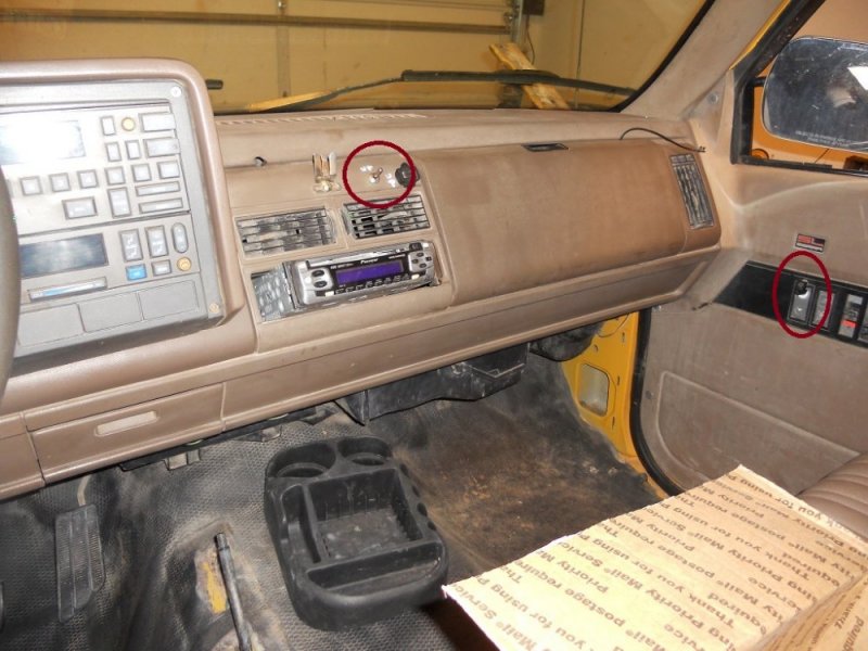

2) 4X4 front axle stays locked in. (they removed the light bulb.) Has the upgraded motor over the thermal mess, but, I suspect wiring wasn't done.
3) Passenger side power window goat and bailing wire ClusterF. Has a switch in the dash to put it up and down.
4) Radio missing install kit.

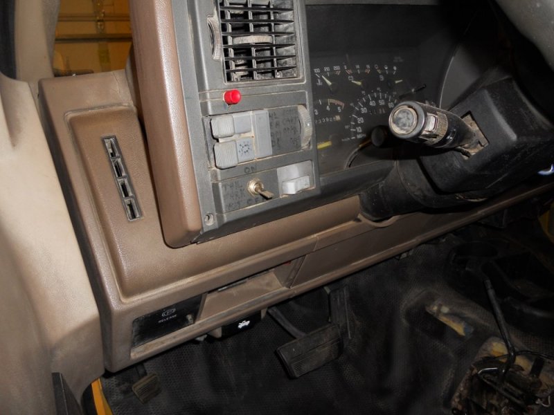

5) headlight switch going bad incl parking lights. Another Goat bailing wire switch...
6) Check oil in transfer case, front diff, and change oil rear diff.

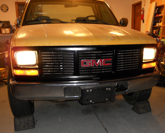

7) Put front grille in.
8) Fix brake lights.
Yes, that's a screw holding the switch in the UP position!
Headlight switch "Run a Bypass".
Least the passenger side seal was good.

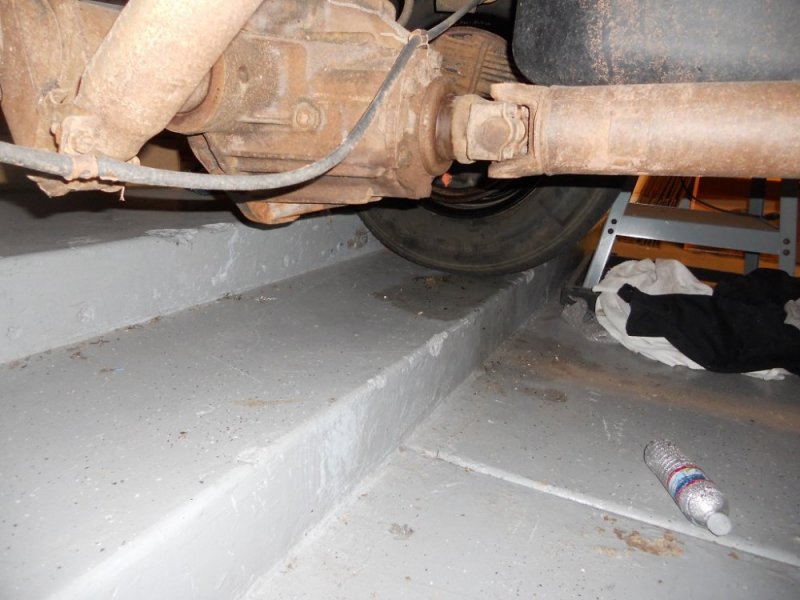

Grille is in. Has a "One Tire Fire" rear diff. Had it on the street and loaded the brakes up to seat the rings. It was rolling, shifted down to first, and lit it up. (OOPS!) Verified open when I changed the diff oil.
I like the front. :) I've been contemplating painting one of my grills black. Think I'm gonna try this weekend.

The exhaust looks lacking....
Surprisingly there is a GM part number on the muffler. It's the only double exit from the muffler I have seen on a 6.5TD. The install and hangers looks professional enough to be factory.

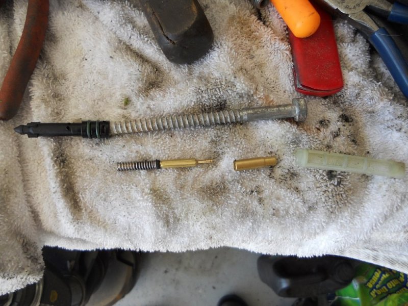

Turns out the VOV I got was plugged solid. Made wrong whatever. So I ran the system without an orface tube and it sucked of course. So I went looking for the OT. Installed the VOV in the evaporator and found it was bad. Removed, put in standard OT as a VOV wasn't in stock and blew the oring out. Redid a couple time till it was fixed. The Orface tube is noisy in the bottom of the evaporator, but, it's blowing ICE cubes with a low 30's duct temperature. This is due to the dmax fan and the KD fan clutch moving lots of air in the under 100 degree weather.
WAR? Removed?... Of course it was stuck and the screen popped off. Then compressed air merely blew the innards out. So a long lag bolt removed the rest of the bad VOV. Damned bad parts took an entire day to UN-FUBAR. The VOV itself is an ingenious device with the spring loaded brass things sliding in and out of the other brass part due to pressure. Phoenix has a larger orface at extreme pressures - if you look closely at the tip you can see the steps that make up the variable orface.
