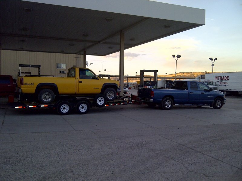

Went and picked this up from north of the middle of nowhere, AZ. 1992 6.5 TD 4x4 3/4t reg cab. INOP and nice and cheap. Work truck with single glass headlights, rubber floor and torn up vinyl seat. Has PW/PL/PS/PB. The PW/PL is odd for a work truck package. Yes the Exhaust isn't original!

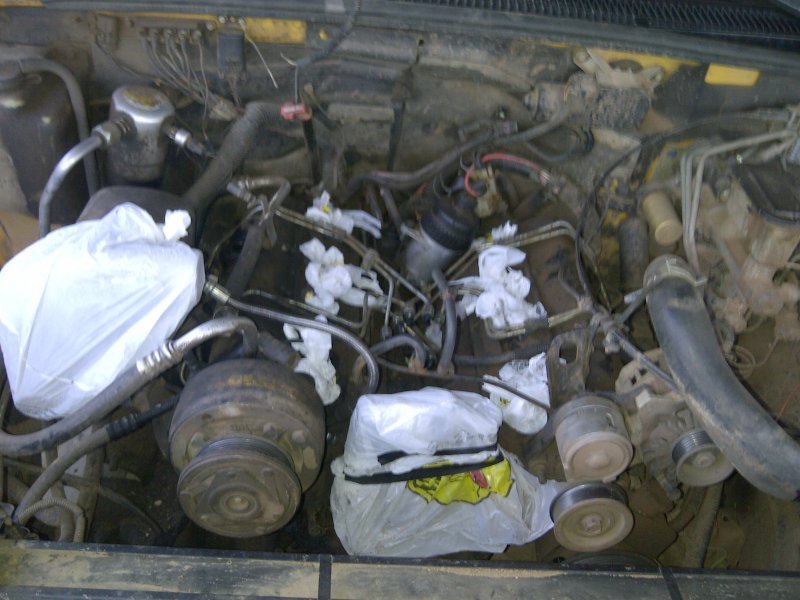

Figure the PO didn't know what a 6.5 needs to start. They pulled the IP the hard way. :hungover: UGH! Worse is the phrase "Quick heat" Glow plugs was used when describing new injectors and GP's. They were thinking of parting the truck out.
Of course the trailer brakes worked only when I didn't need them and I went through the 6.5 killer grades to go get it. There is a limit to the exhaust brake... :eek:
