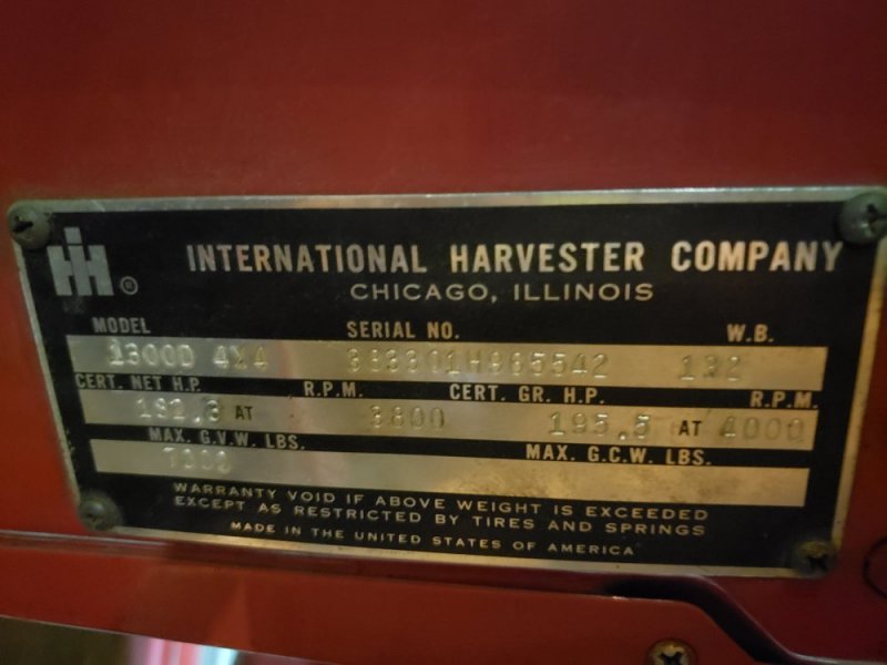

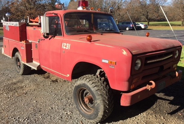

As some of you have seen before this rig and know I have had my eyes on it. The truck is an old IH fire truck. Some back story is the truck:
It was utilized on an Alcoa Foundry. I'm assuming all its life as the odometer seems legit with 4,600 miles. Reasoning for legitness is pedals are in great shape along with the rubber floor protector near the heel of the accelerator. My company purchased it to pump water for dust supression. Pump died on the truck and my company replaced about 3 years ago. Fast forward and the job has been complete for 2 years. The tuck has sat in the shop since with only myself running the truck intermittently. Hell I took this thing to my local fireman field days a year and change ago and it received a ton of attention. It has not title, but luckily in NYS titles only go back to 1972. So only a bill of sale (bos) is required to register (per my current research). I dont think this truck was ever registered and road driven. It has a working Hobbs meter sitting at just over 1,000 hours.
Finally after years this truck is now mine. Plans are to perform a complete brake job (only 1 wheel stops currently), and a full tune up and fluid/filter change. Hopefully it will be road ready by the Syracuse Nationals 2020. For now the ride will be slow. Trying to locate proper winter storage and potentially having the option to work on it. Purely getting it driveable in as-is condition. The restoration will try and encompass OEM type parts for a near original build. Pics or it didnt happen....IMG_5681.JPG20191004_101004.jpg20191004_101052.jpg

Spent some lunch time today attempting to pressure wash the bulk areas of caked on grease. Mostly concentrated on the axles and frame. Found out I am leaking fuel profusely from the carburetor. That will need attention sooner rather than later.
Ah, good old Holley. My favorite carb.
Can’t see if the leak is from the float level or the flare inlet adapter because of the shadow. The little seal on the adapter is common leak.
Remember that style carb, a timing advanced back fire through the carb ruins the power valve. So if you(or someone before you) set timing and she just doesn’t rev up smooth afterwards, kinda big hesitation with vacuum sound then revs, that’s the go to issue.
Most of the leak looks to be coming from the bottom of the bowl. Like the accelerator pump area. I think the fan is blowing it around. The inlet is finger tight but could still be a culprit.
It needs a tune up bad. Misfires all the time and bogs/stalls when cold. I cant wait to work on this thing. Nice to get back into vintage stuff.
Yeah, same trick as diesel: add some atf in the fuel. It cleans out jets and swells the seals. We used to just rig a 1/2 gallon with about 1/2 cup of atf and rest it on the roof, then gravity feed down to the carb. Run it in the driveway varying rpm. Then we would Do that with the water down the butterflys to remove any carbon from pistons and valves. Figured as long as we were ticking off neighbors, make the noise and the smoke all in one day.
Once that was done, check timing and reset the floats. She’ll be a happy camper.
