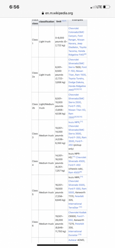

So the 2001 gm 2500 2 door 2wd pickup with duramax is rated as class 2b at 8501+ or class3 at 10,001+ ,, but my 2001 2500 4wd which had actual weight of (8700 btw if that helps) was not rated heavy enough for the duramax engine by emissions standards?

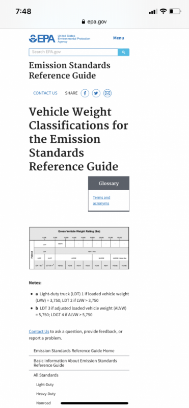

Then the other problem. The EPA set limits but emissions testing are state to state. But neither says your engine is a specific size. Duramax is used class 2b (vans) through 6. They can stick a duramax in a car the size of a smart car, it just has to pass emmisions levels- which btw read the specs. The duramax passed them down to class 1.

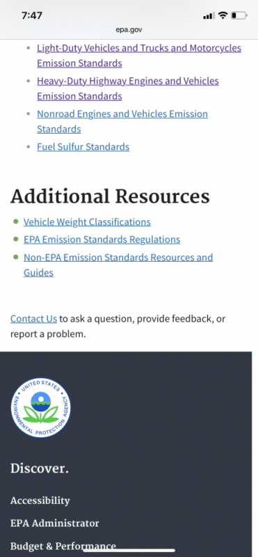

The EPA listed law doesn’t even separate the test. Couple more pics.
