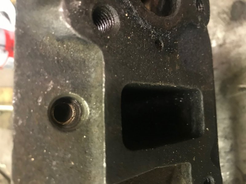

I think I know what you're saying about the other passage. I've seen pictures of the passage between the valves being 2 ways - a long passage that dead-ends at the outer wall of the pre-combustion chamber and then the pics you shared where it had that bolt cast into the passage, blocking it. So far any heads I have looked at here are the first type, with the long passage that dead-ends. I toyed with the idea in my head of tying the passage between the valves into that other coolant cavity above it. I have some ideas on the method of doing that, but nowhere near having an idea on the orifice size to use. The brass tube has an ID of about 5/16", it seems like that would large enough for plenty of coolant flow. This is all stuff I was thinking I would play with in the future, certainly not on this set of heads. That may be the trick that stops the cracking though....

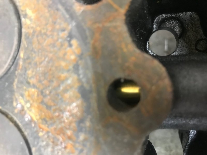

I spoke to a machinist that I used years back and he laughed at me- said he installed the tube in heads he did for me. I never even knew. I went back and looked at a couple old pics and sure enough they had the screws in there instead of the plugs.
