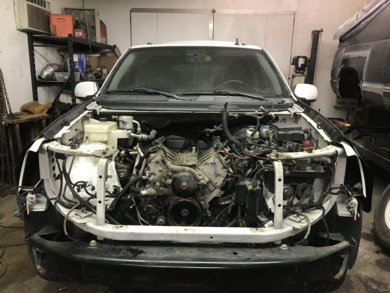

And started the tear down. Still a ways to go....

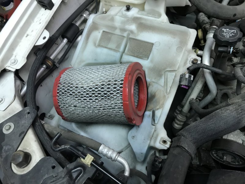

The washer solvent tank has a built-in filter cradle. This should make building a cold air intake easy.

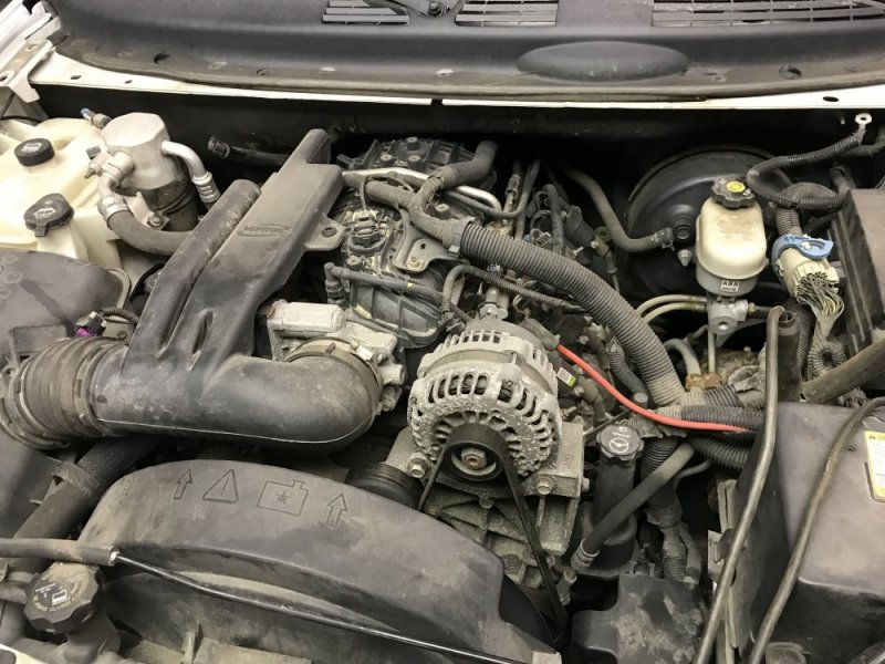

Tonight I got the truck up on jack stands and rolled under it to get myself acquainted. Man things are really packed in under here!! I sure miss wrenching on my GMT400. I spent a lot of time working on unclipping wiring connectors and harnesses. Then I decided to remove the transfer case. I got it out though it wasn’t much fun having to leave the front driveshaft attached due to the CV joint at the case. I’m not really enjoying rolling under this thing to work on it....I sure wish the Hoe wasn’t living on the hoist right now!! The starter is ridiculous on this thing - I’d change 5 6.5 starters before I did this one. It’s coming out with the engine and trans and I’m putting a new one on while it’s out. I can’t see how you’d change it...at least it’s not apparent at the moment. DED239C7-9386-4647-AAF8-C81BA515A9C9.jpeg
The good thing is LH6's can be had in running condition for $500-800 since nobody wants to deal with the AFM delete. Remember if you delete the AFM, you must swap the cam as well. And I'm sure you're liking how the front diff is part of the engine's oil pan.
Yeah the diff is the next thing I’m tackling....
I’m hoping the heads are still good on this engine because they should compliment an LQ4 short block nicely. I’m still researching combos.
Last night I got the exhaust Y pipe and axle shafts disconnected.....yes, axle shafts. As Ferm eluded, the front diff is part of the oil pan so you have to remove the axle shafts to yank it.
Tonight was a final push. It was a struggle (the diff and motor mounts are a maze you have to traverse to get it out), but I finally got it pulled. Tear down will begin in a couple days.
