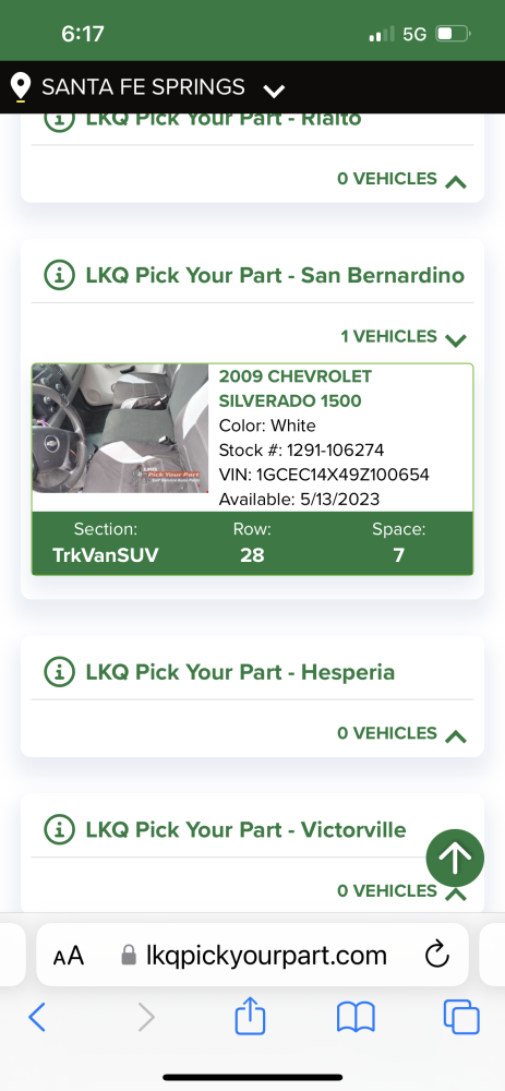

I can get seats for 2007-14 or 2014-20 for $139 when the truck arrives in a Pick-a-Part yard. Anything older than 2007 would be best to shit and still the same price. So I’ll be on the look out for a truck from that timeframe with brown interior.

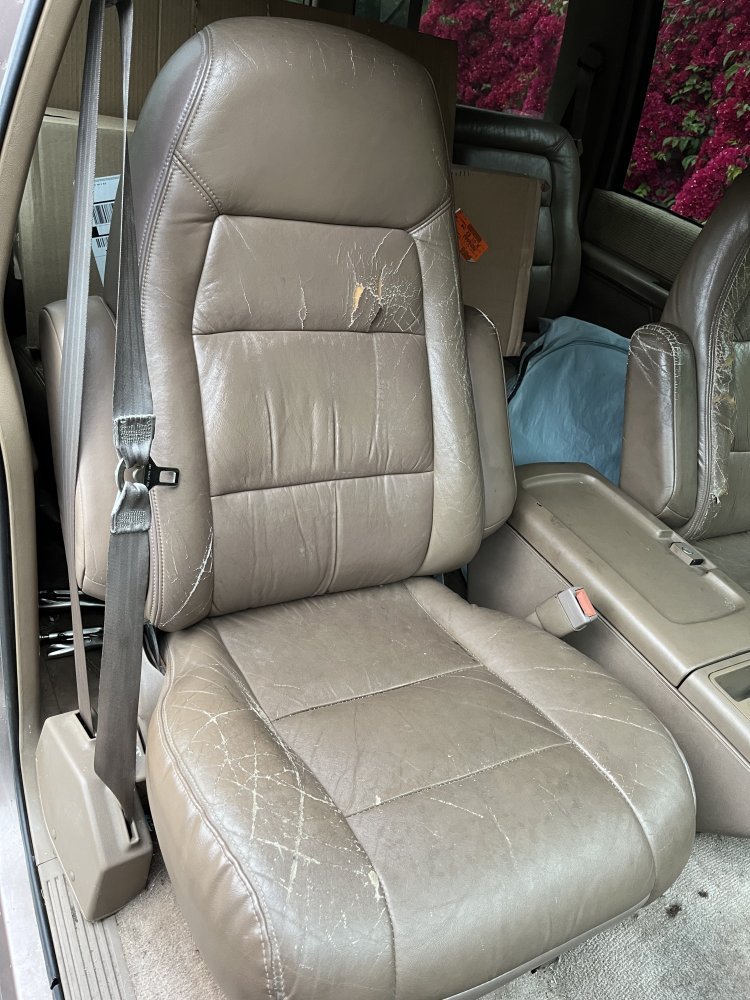

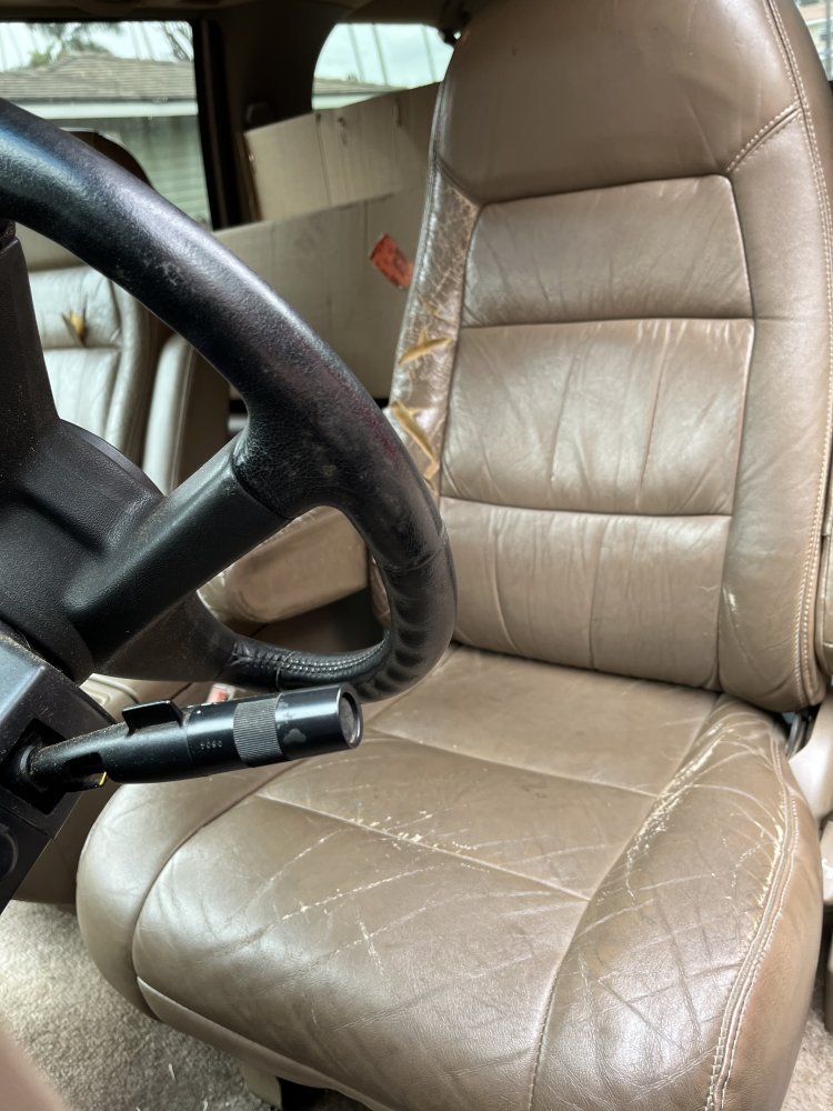

Have you checked local upholstery shops? Last time I had a set redone by a shop here was $250 for the front buckets, didn’t even pull the seats. Granted it has been some years, but wouldn’t expect too much increase of price.
No I haven’t. I have found the coverings made to fit this seat, both leather and cloth. I would like the Carhart Real Tree Camo over the leather. As you can see, this is not urgent, but a nice to have done. More urgent need is a paint job and redo of the headliner.
Those seats don't look bad at all for their age. I bet a good upholstery shop can fix them up easily at a good price, making you a happy camper
