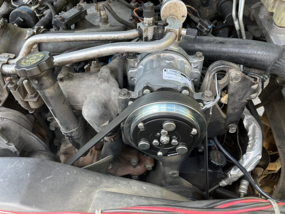

Hear that whine? It also changes when steering wheel is moved back and forth and when steering wheel hits a hard stop. Not impacting steering itself.
Is this my power steering pump going out?
Anything on the belt drive is affected by changes to load on the belt drive. PS pump changing the load make may another item make noise or not. Remove belt and feel every bearing by hand.
Sample the PS oil. Assume it's at the proper level?
Pulled the serp belt and the only item making noise is the clutch on the ac compressor:
Ironically this was the conclusion both my son and I had while it was running. The ac compressor itself is working. It is a Sanden unit. Can the clutch itself be replaced, or is this just replace the whole thing?
Get a genuine Sanden replacement. I find the clutches cost as much as a new compressor so buy a new compressor and: replace it or swap just the clutch off the new compressor. Evac and recharge will cost more.
IMO replace the compressor as the 1st vid noise is loud enough to justify it even if working. So add a new accumulator, OT, service valves (always replace these) flush and oil to the cost.
After I spun that, I took ac repair for $500.
I was going to say that if the ac is not leaking and cooling good, it might be worth renting a clutch puller and just replace the bearing in the pulley.
there is a good chance the bearing alone is readily available. auto parts won't list it under application but you would need to pull it and get the SKF or timkin number off the bearing.
I bought a new Sanden Compressor. I will have the ac repair shop replace the parts WarWagon listed. I don’t have the experience or capability to flush and recharge the ac system.

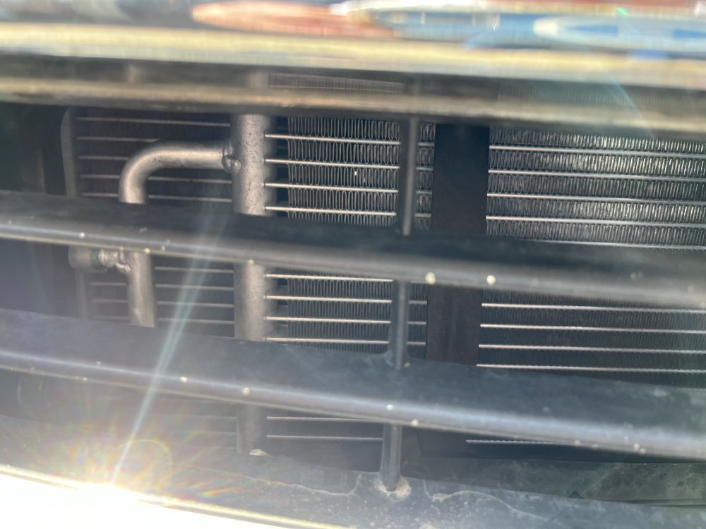

I went the distance with new everything, including condensor. It’s expensive, but I don’t do ac work.
If you can afford it- replacing everything at once is the best option.
