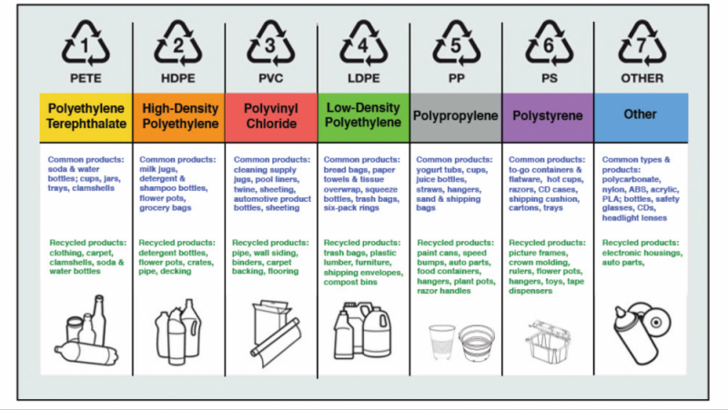

So whats good and bad?
1,2,4,6 are most desirable. 5 is ok, but not a high yeild. So takes about as much energy to process as youbget out in the end. Still profitable for the company, but might as well skip
It because as plstic prices rise and fall, has potential to loose money.
3. The PVC- Momma says your the devil. It HAS TO be removed. There is multiple ways to easily seperate it.
7. OTHER. Ok, anytime you get anything that says “other” as an ingredient- run dont walk. Might as well not even have a number on it. Total garbage no one anywhere can use it for anything I have ever heard of. Maybe use as toxic fumes for child molesters breathing treatments while rolling them in the melted plastic? I get side tracked- sorry.
So there is a market for recycled plastics. The most expensive stuff is pete, and polyethylene 1,2,4. 2&4 are basically the same just more/ less dense. Anyways back at $100 bbl oil, pete was running $0.30 per ton - last I looked was years ago though. 2&4 were around $.020/ ton.
But that is clean and seperated condition, melted into blocks.
