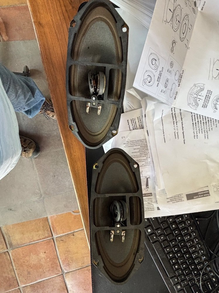

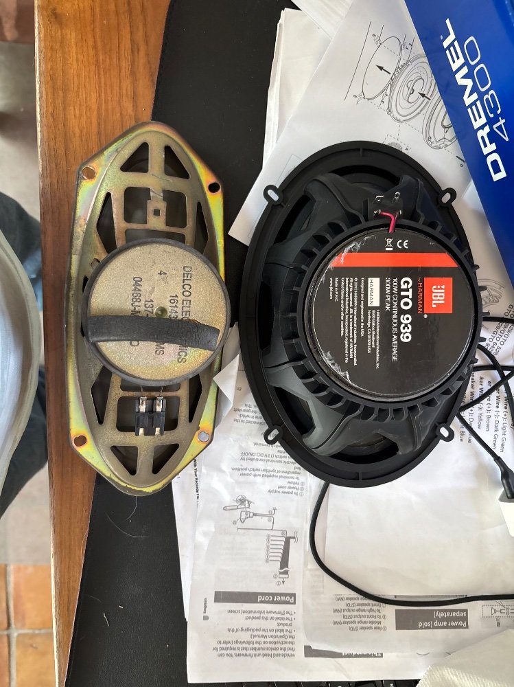

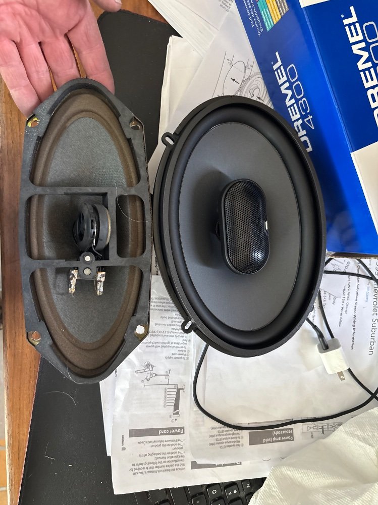

Rear roof speaker update: Rear roof speakers are blown. I tested the wiring in both locations with one of the new JBL GTO-939 speakers and it worked in both locations. I need to trim an arc in the backing metal to clear the larger magnet on the new speakers. Also have some Metra plugs on order for the quick hook up. But finally the finish line on this install is in sight.
