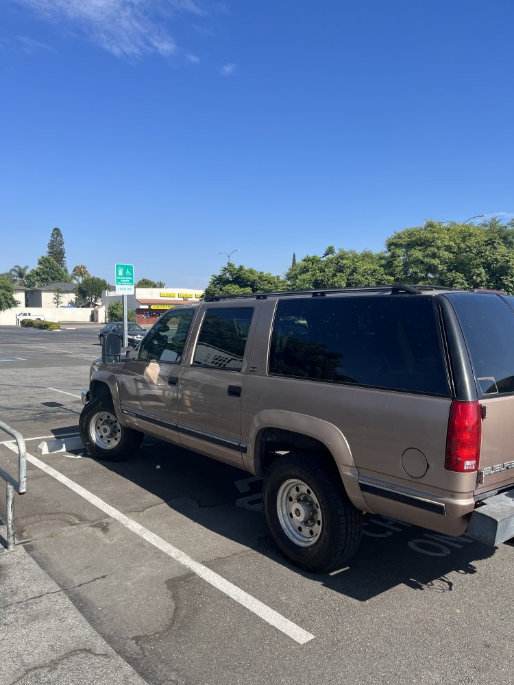

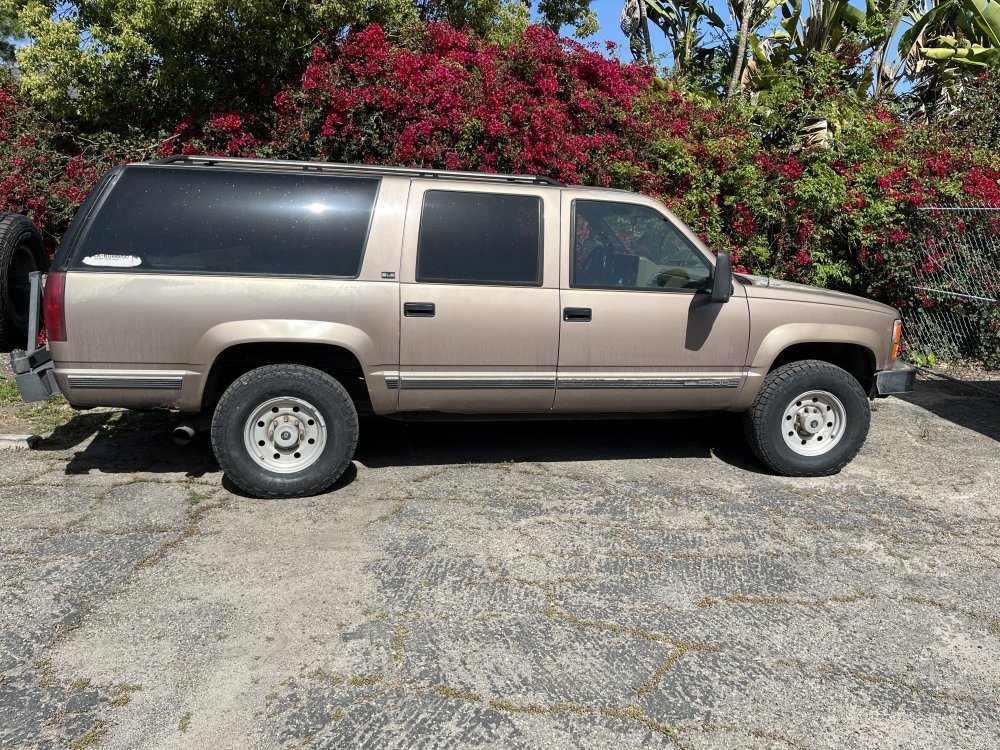

She's has a hard life lol. Kinda looks like shes sunk in the ground too. Looks good though. I would like to find a roof rack that would span over my crew cab similar to that. I like your neighbors cactus garden!

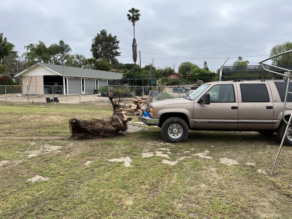

I got it stuck trying to winch out a giant eucalyptus stump from a tree that fell into my neighbor’s yard. Should have waited for the ground to dry out. This was back in February of this year.

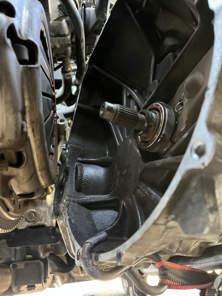

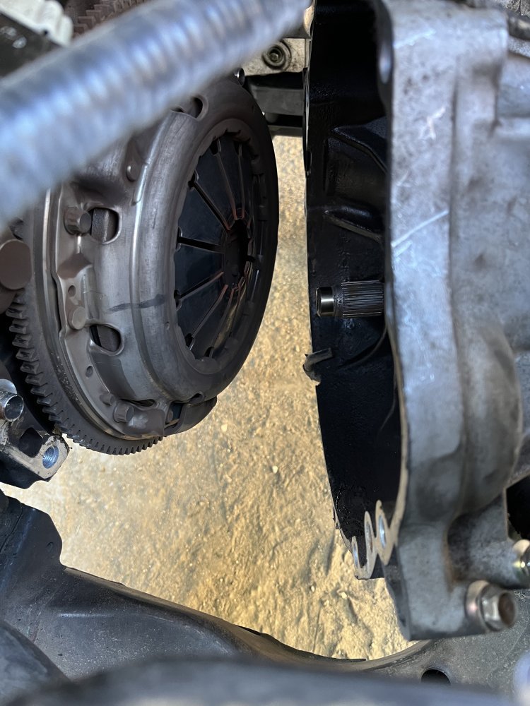

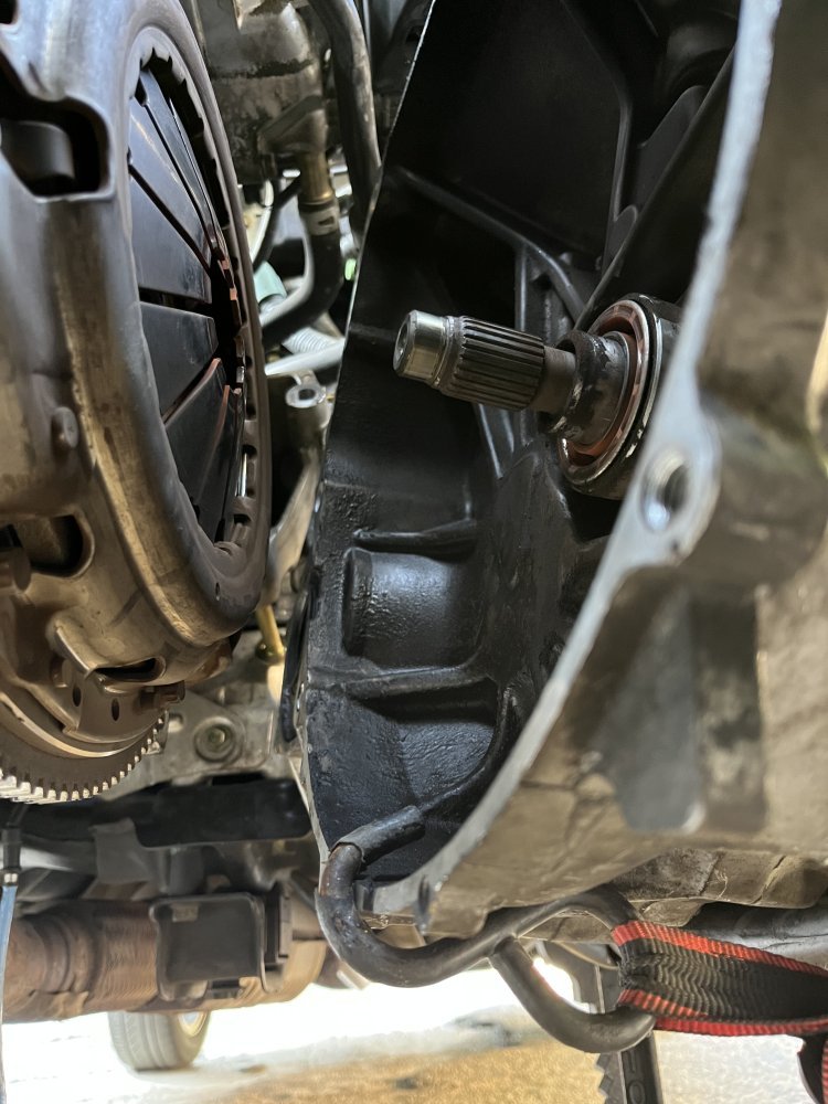

Got the transmission pulled on the 2005 Honda Accord. I now have access to replace the cluth, flywheel, throw out bearing, pilot bushing and rear main engine seal, but that will happen next weekend. It’s Miller time.
View attachment 83629View attachment 83630View attachment 83631
I’m sure You are well versed on how to remove the old pilot bushing/bearing if You dont have a puller system.
Pack it with grease. A shaft/bolt/etc that just fits the bore and drive it onwards with a hammer, pack in more grease as needed until the bushing pops out and hangs on the shaft.
