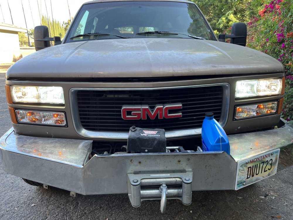

Fixed the one left turn signal bulb:
Didn’t want someone to nag me with a honey do list. Enjoying single life here for a week while my wife is in Austin area of Texas, undoubtedly broiling.

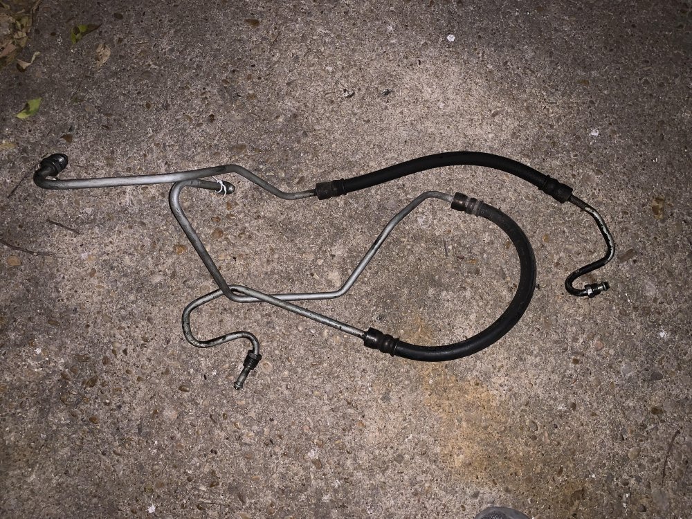

Well got home from work this afternoon, pulled the truck into the back driveway and up on the ramps. I had the "too small" gear box out and the other one installed rather quickly! I even did some R & R on the pressure hoses as I had noticed even with swapping out the boxes I still had what sounded like a slight wine coming from the pump as if it was getting air.
I remember I think it was Will who said before that it might have been sucking air from somewhere. since I didn't have any new hoses on hand I decided to put back the hydraulic hoses and fittings I had made for it a good while back when I was trying to rule out my pump on another steering issue. I don't care for how it looks with but I went for it just to rule out anything with the hoses.
got the fluid in and full, it took almost 2 quarts this time around. Backed it off the ramps and steered the wheel back and fourth sitting in the driveway.... WOW what a difference! it steers like butter with no noise or pop sounds. No creaking ether! I have not taken it out for a drive yet.
While I have the truck in the back, I plan to replace the lower radiator hose and fan controller in the morning. I already have the new fan controller dialed in to turn on at 200+/- degrees with the help of my son, we pre-set the temp on it with a pot of water on the stove so I'm not having to monkey with it too much once I get it all wired up tomorrow. :D
Here are some pics on the Hydraulic hose routing, I'm not liking it too much but this will do for now. I had used this setup back when I was testing pressures and flow from the pump and throughout the system, I just left out my other fitting that allowed me to use a gauge. when I pulled the OEM hoses off I could see where both were apparently seeping fluid around the rubber, time for them to go.

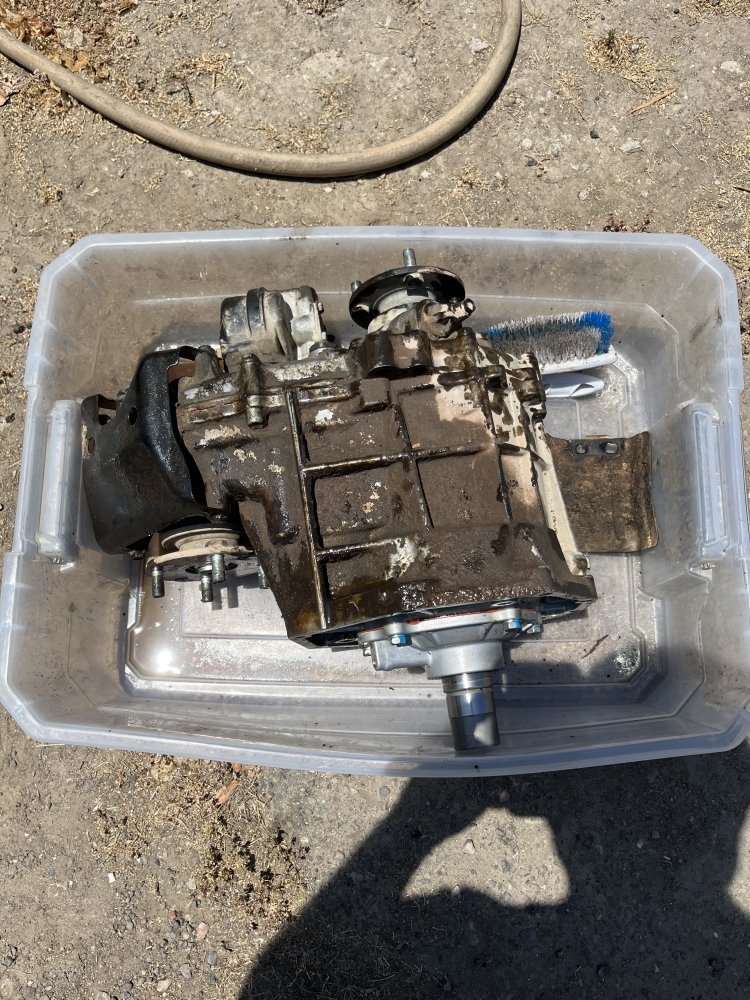

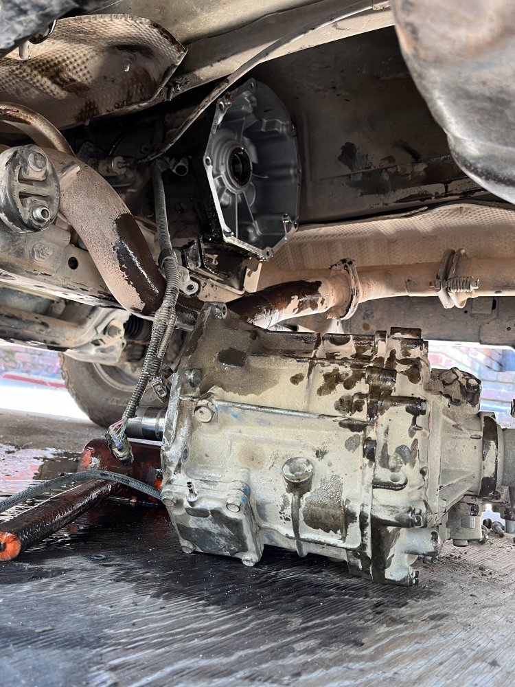

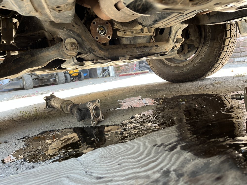

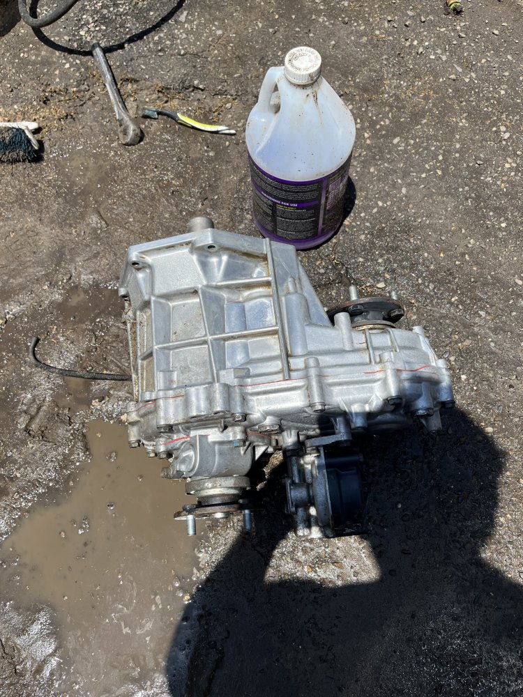

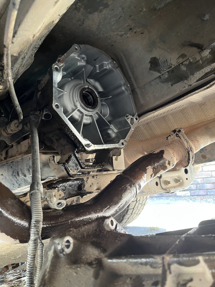

2014 4Runner with 336K miles had a leaking input seal on the transfer case. So I pulled the transfer case. There was almost a quart of oil between the transfer case and transmission. I have the input seal and rear housing seal, but saw the transmission seal and might as well replace that while I’m in there. That seal will arrive at the dealer on Tuesday. So this project will get delayed a bit.
The way the two housings mate almost makes me think there was no need for seals on the shaft! just a gasket to join the two and have the extra fluid capacity for both units! LOL
Unlike my K2500 Suburbans that use ATF in the transfer case and transmission, the 4Runner uses 75w90 synthetic in the transfer case and synthetic ATF in the transmission.

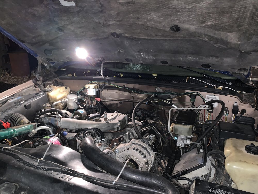

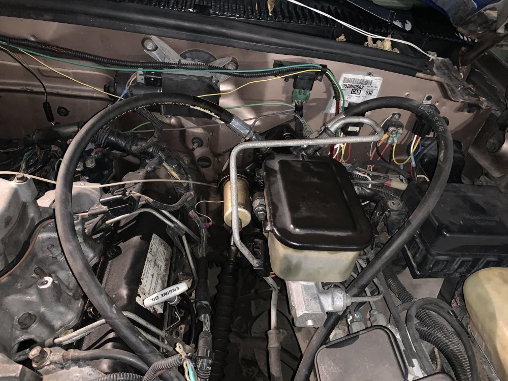

Wired up the new controller, relocated it to the captains side firewall next to the other two relays I have there for the lift pump and headlights. picked up some loom from Home Depot and cleaned up all the loose wires running across the firewall. even loomed up some of the other wiring to the AC compressor and various items making it all look much better.

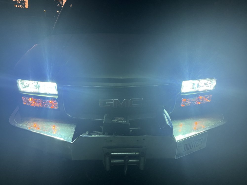

Should really do some reading over on HID Planet forums before you go dropping those bulbs in halogen housings. You are actually blinding everyone else on the road with that setup and real projectors will give much better light output for you too.
Bro they’re fine. Best lights I’ve ever had. No one is giving me the Hi beams when I’m driving. If I wanted people telling how I should live my life, I’d stay in California. Wait….
BTW they are specifically not the halogen housings. Halogen housings have ribbing in the lens which scatters the light. These are euro clear lenses. The Lo beams have a cup over the bulb so they don’t burn the eyes of oncoming traffic. These were the housing style and lenses recommended by people here for HID lights.
