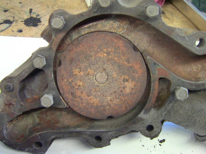

Just a FYI post, I will be testing the Flow Cooler water pump soon along with a few of the Kennedy Diesel cooling parts. I thought I would show the differences between a stock vs the Flow Cooler unit.
The Flow Cooler impeller is CNC machined and has 10 blades. Also the WP body has been machined and the impeller is thicker than either stock or 130gpm unit.
The stock is cast and has 6 blades. Not shown their is the 130gpm version where the impeller is almost 1/4" wider but still has 6 blades.

Well, it looks like I need to slice a couple pumps in half and see for sure, I do know the passages seen in these pics are the same on the 130gpm screw on pump. If I can find a old used screw on pump to slice I'll find out for sure..
It has to do with the passages and the 1 port or 2 ports of heater hoses.
If you bench test just the large hose input to the pump and the 2 outlet ports to the block, you will get one reading. Then when you bring in the heater hose port(s) it comes into play.
The balance isnt just a case of volume. Temp of incoming fluid and where it feeds out gets affected too.
