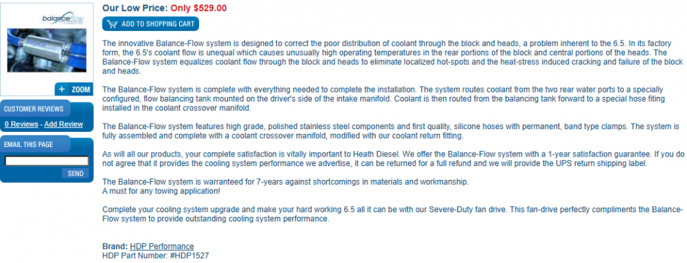

I still wish there was some rebuke of the original Balance Flow kit in writing. There was a nod to it in the beginning of this article, as well as the multiple temp probes, but no direct mention and no mention of it not actually performing as sold to do. Just crickets...
