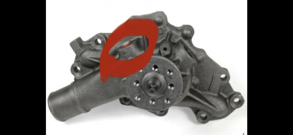

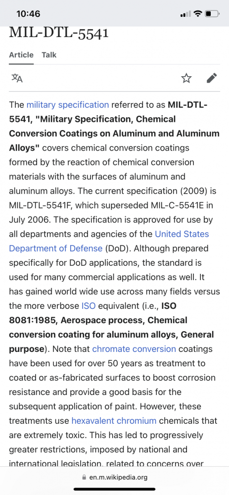

One last thing about their snake oil slinging speak- “color is due to Type II Class II military grade surface coating” ok- plenty of military folks here. Anyone know where to look that up? That is some bs there. I mean- they already are trying to argue against the laws of physics so why not the military nomenclature as well. Look at the pic and see what is meant. Then tell me who here had their impeller wear out as the issue why they replaced their 6.2/6.5 water pump. Instead of the front seal failure that sends coolant out the weep hole so you don’t seize the bearing and have your fan be the giant ninja star of death.
If that coating is all that and a bad of chips- why aren’t they selling it on the backing plate which actually surfers the damage they are trying to protect against.

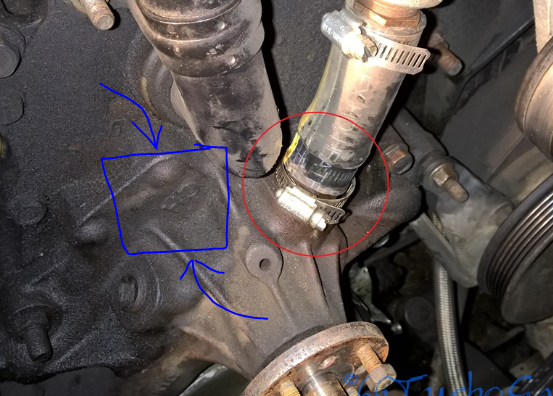

Last take a look at what year vehicles this works on and doesn’t work on. They don’t even know the interchange years.
With the known problems that experimenting with 6.5 cooling has brought about- no way can I afford to blow up an engine verifying what they think will work with what we know works- after GM spent millions trying to figure it out.
It just pisses me off when any company wants to pedal snake oil and and acts like it is king daddy when they haven’t even actually tested it on that engine enough to see their holes don’t even line up. Yeah if you do remember that part- ya might search it - but to be fair that might have been hummer forum not here.
