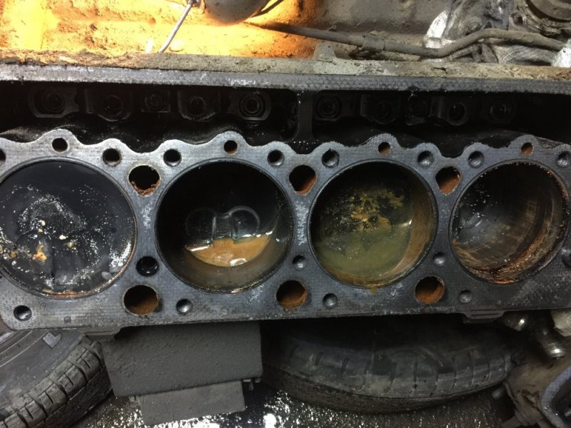

It looks like water. Was it just water or was it antifreeze/coolant. Is it exactly the same as what was in the radiator? Mighty intersting that it is in both sides of the engine, kind of a big clue there...Hummers have a way of making the driver try to drive through too deep of water and hydrolocking the engine. It's like a magical power they have. Beware of this on your test drive -haha.
When you took apart his cooling stack, how bad was it between the radiator, oil cooler, etc in the stack?
If it is coolant- first cylinder to look closely at is #8.
With the unbalanced waterpump and the added heat load that hummer have from the junk radiator angle, then the turbos have the uppipes right next to the head of #8, there is a huge conspiracy in the hummer world that all 6.5 engines crack there due to a casting defect. It is a weak point because of the waterpump, but once the balanced flow one is on the failure rate goes way down.

Check trans, both differentials, and all 4 geared hubs for water. They all have vent lines, but if it went crazy Ivan, they could all have water... in fact fuel tanks also.
