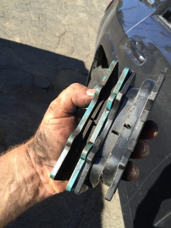

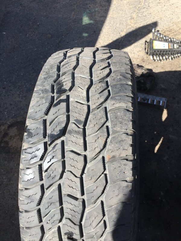

As noted, this was at 75k miles. Attached is a pic of the tire at 20k miles and of the old vs new pads. I estimated 10K to 15k left on the old OEM pads, but changed them anyway. I was getting brake feeler squeal on initial application at mid speeds, though no indicative scrub wear on the rotors.
Shocks are OEM. No bounce in the ride post brake job.

As said above your tire picture matches worn shocks. May even need to run higher (+5) PSI in them if both side treads are worn more than the center. Ball joints and other suspension wear deserves a fair test.
