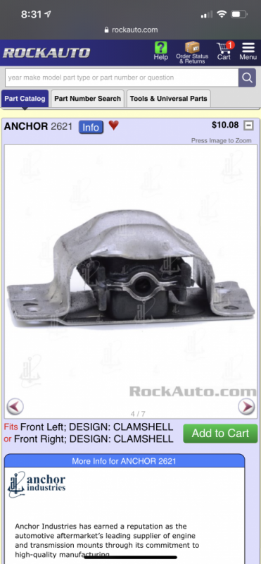

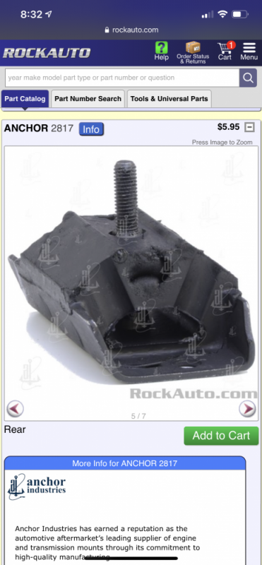

I will have a look at the cab and body mounts possibly this evening after work. I was trying to find a photo online of the mounts just to see if they might be reversible. I think their made like a two piece donut rubber and a center sleeve if I'm not mistaken

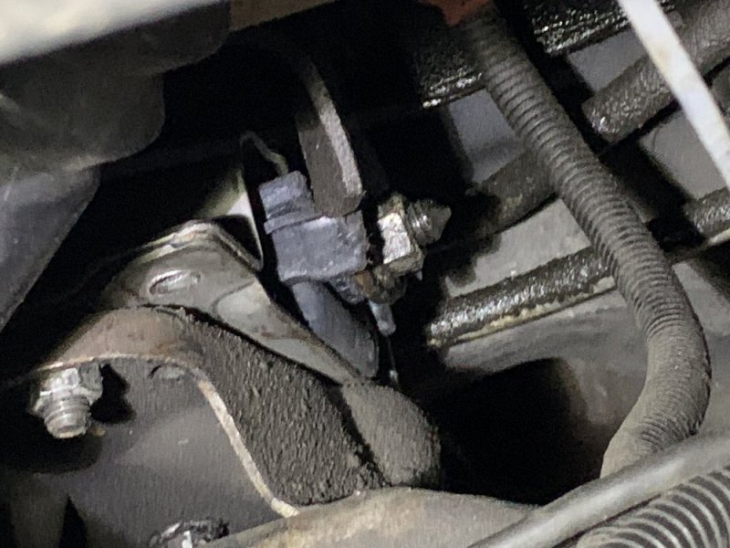

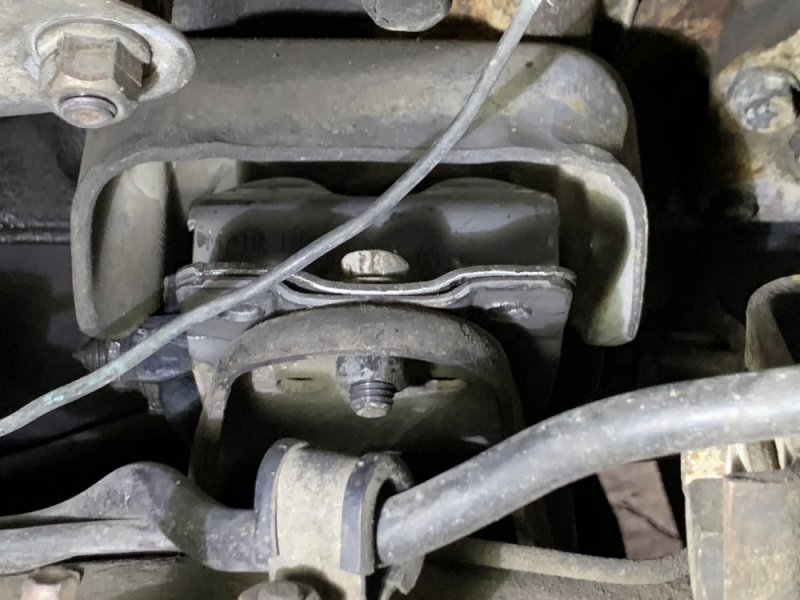

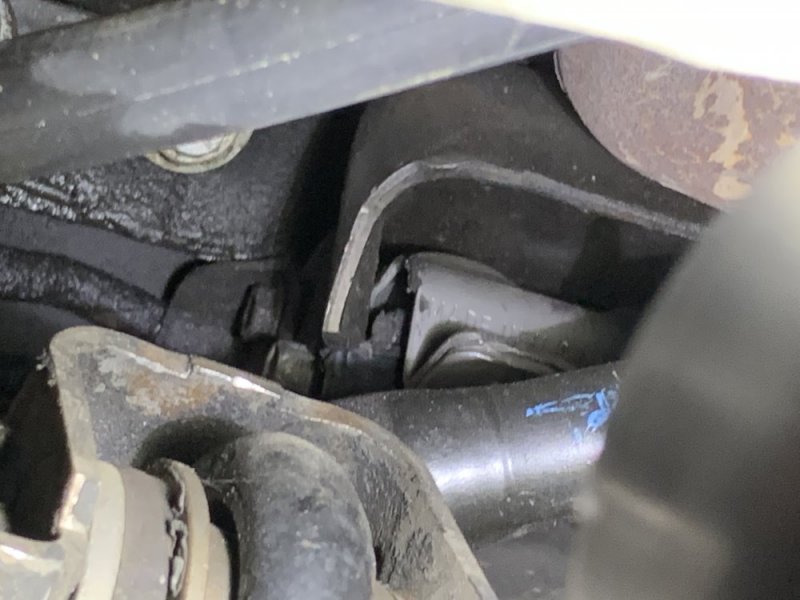

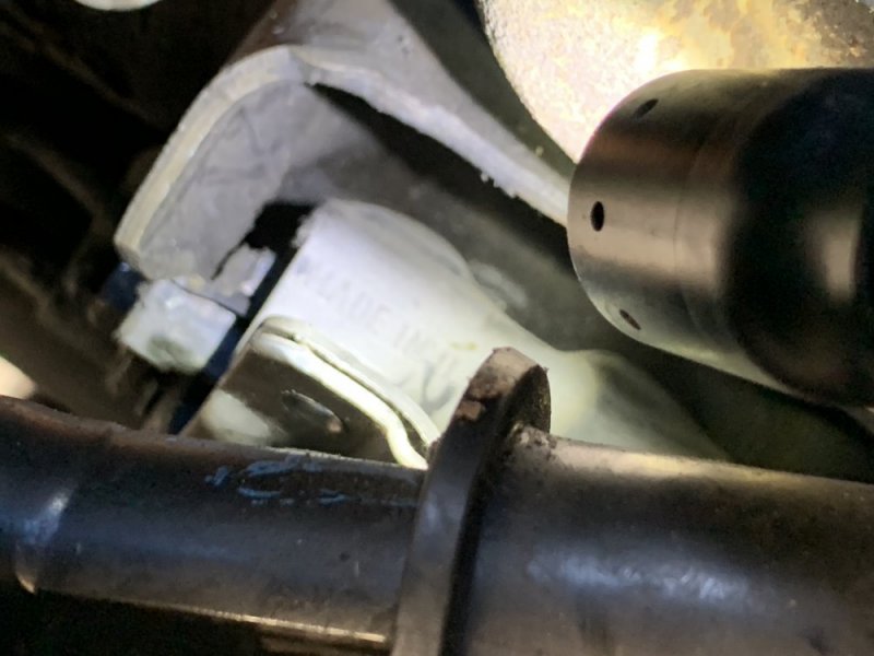

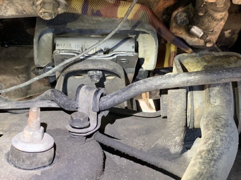

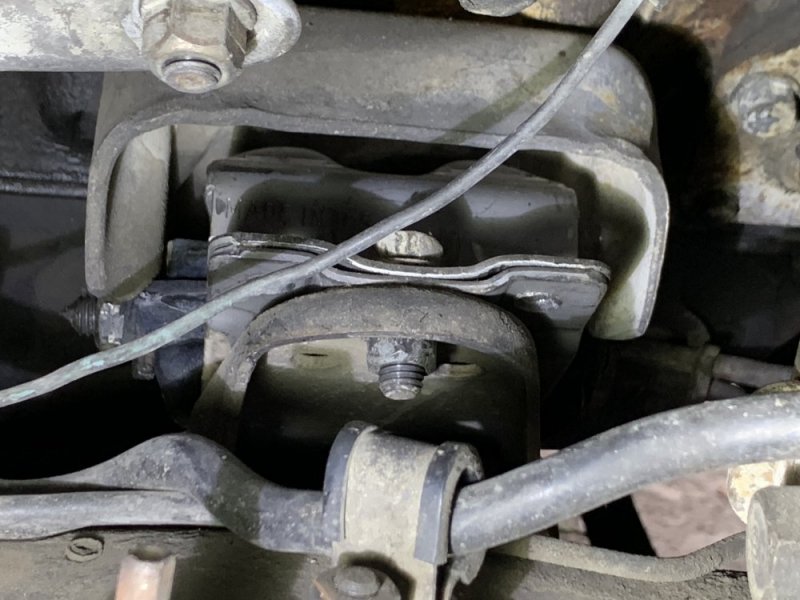

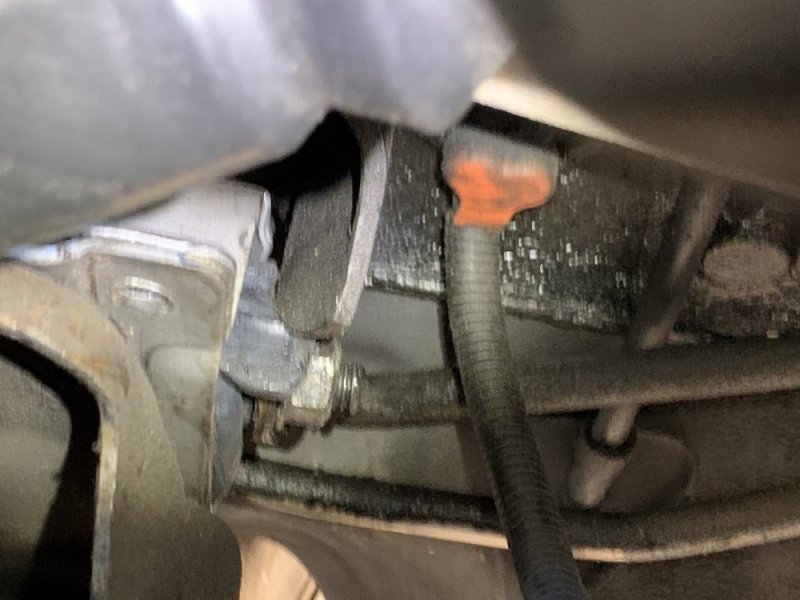

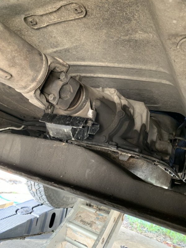

Hey I found something odd. I was looking at the motor mounts and they seem like there being pulled back a bit. I took some photos of them with my phone. Does this look normal?
the first two are of the drivers side, last two are the passenger side. It’s like there being pulled towards the back

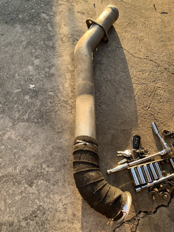

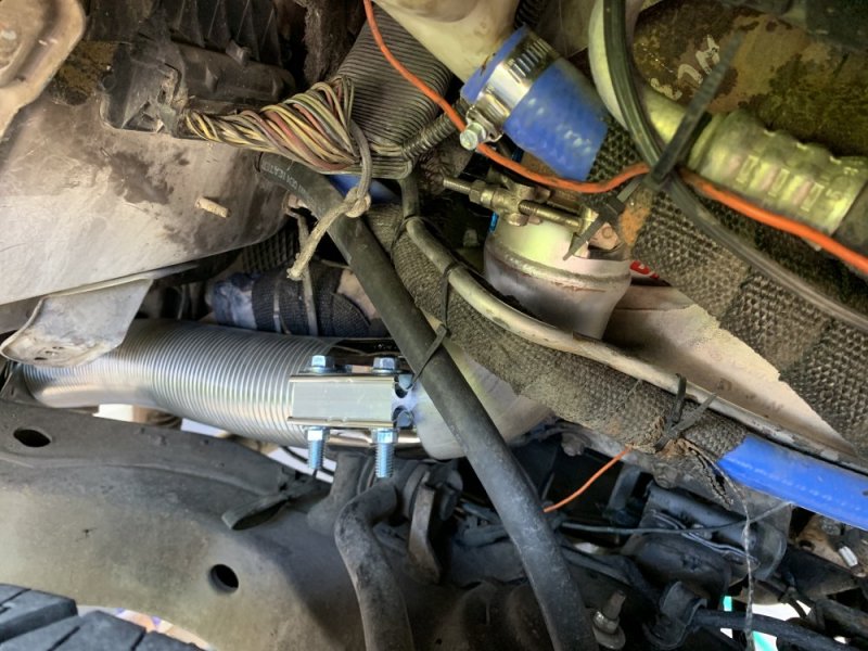

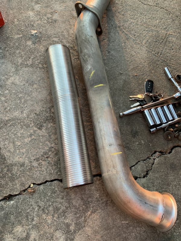

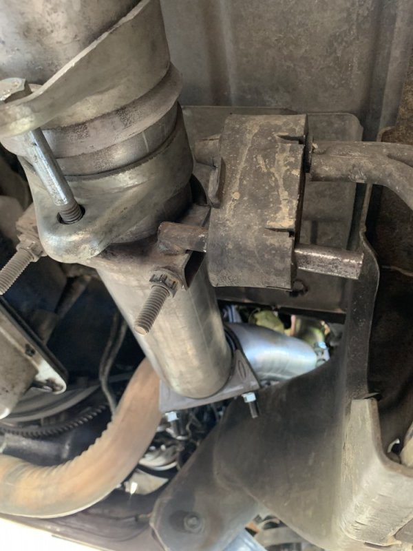

I did try something else too. I remembered reading somewhere about a similar issue that turned out to be the exhaust pipe causing vibrations. I slid under the truck and loosened the down pipe to intermediate pipe where the ball shaped joint is. Cranked her up and the vibration is much less than it was! Now I’m wondering if the flex pipe idea I had by cutting out a shot section of the down pipe and clamping some flex there will solve the problem.
I know on one of my trucks the down pipe was touching the cab after I put the ATT on it. I had to ream the slots out further on the down pipe elbow to change the angle.
Agreed Les, I can't remember if there is a left and right. By my memory they are the same, even then I marked which was which. I used the Poly insets and rebuilt the ones on the 1 ton.
