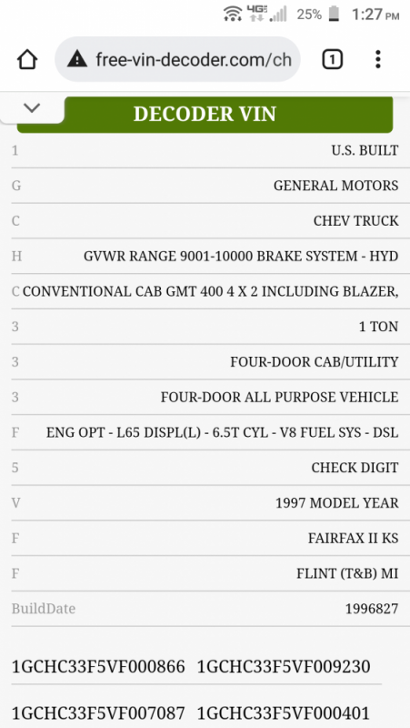

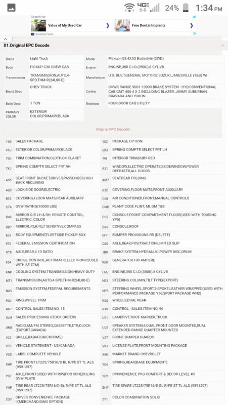

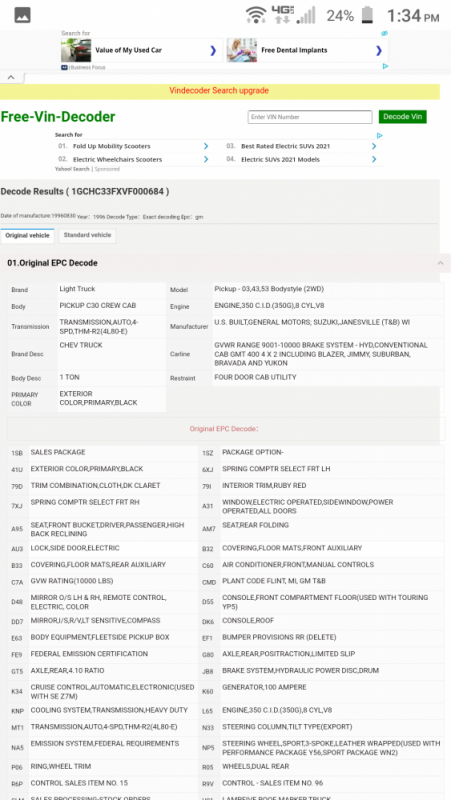

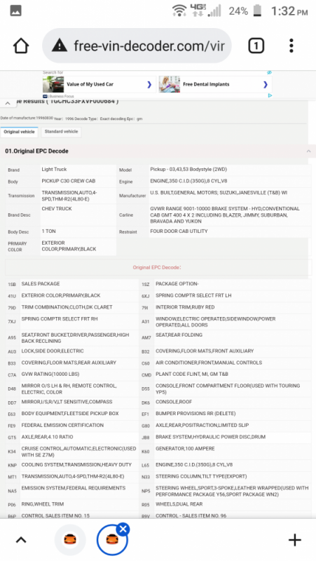

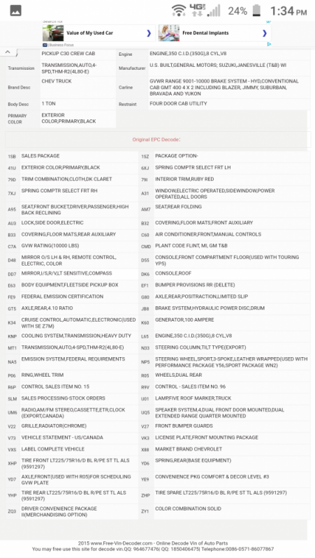

I'm kinda confused. I ran the vin on my truck the other day. Granted I didn't buy the truck new so I truly have no clue what could have been done before. Anyhow the vin search came back saying the truck had a 350 V8 in it. Not sure if by some chance something is incorrect with their data... Or if the truck actually did come with a 350 and was converted...
Honestly at this point I kind of wish it Screenshot_20220417-133423.pngScreenshot_20220417-133436.pngScreenshot_20220417-133417.pngScreenshot_20220417-132747.pngScreenshot_20220417-133259.png had one in it
on your screenshots above, RPO code L65 is not a 350
L65 RPO Code Description of RPO (vehicle configuration options) code L65 . ENGINE,6.5L (6.5F),DIESEL,TURBO HIGH OUTPUT
found this online.

Your VIN Decode was correct, 8th digit F - L65, 6.5L Turbo diesel. The RPO decode source is totally wrong for decoding the RPO number as a 350 gasser. Use GM's if you want to know the real answer, not some aftermarket website's.
