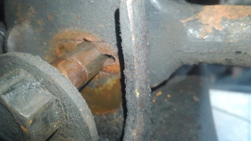

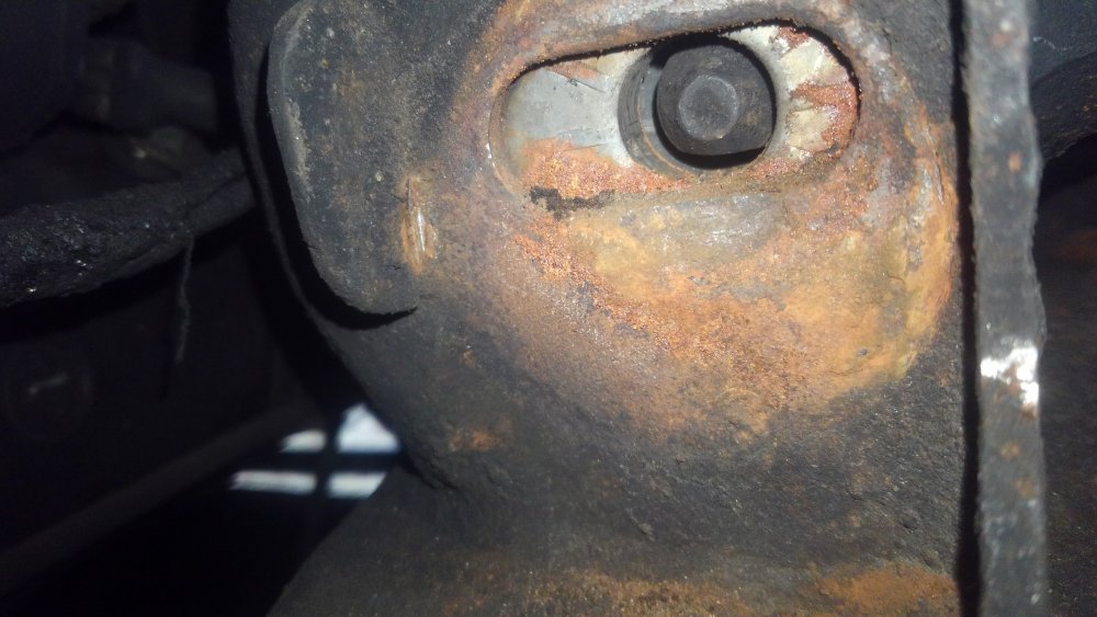

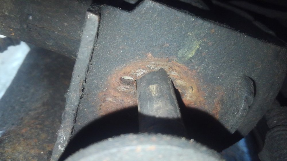

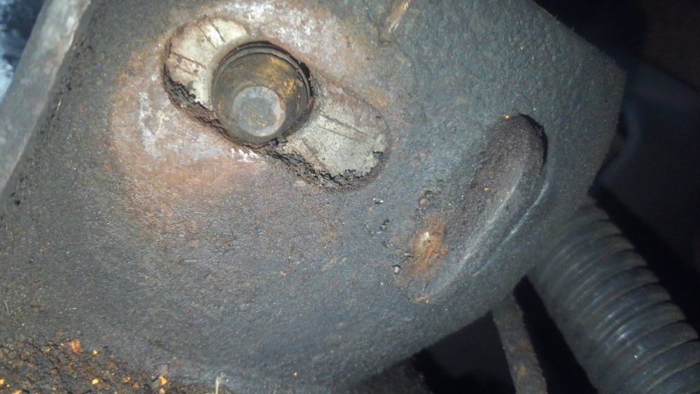

@dbrannon79 ... just to verify after going back and reading your comments..when you said, "ok the rear are about centered and the front on both are slightly outward for their adjustment. there are a couple of other things to check before making any adjustment. with both tires pointed straight, eyeballing both left and right sides, which looks to have the tire where the top is leaning in? (the problem child)"
You are aware that all those pics are of the passenger side right?? I have not posted any pics from drivers side.. only reason I ask is because the way you worded that comment made me think some were one side and some were other side...
Yes I was under the impression the first two pics were the left and right for the rear mount on each control arm and the second set was the front on both sides. my apologizes. from what I saw, one bolt was in or about centered as far as it's adjustment in or out movement, the other was slightly more towards the outside. both still have some adjustment to move them out a bit, but you might see maybe 3/4" to 1" of tire movement with them both fully adjusted outward.
it won't hurt anything for you to jack up that side, support the lower control arm so the spring doesn't give you any unwanted surprises and pull the upper control arm loose from the frame. just take a paint marker or something to mark the position of the washer on both front and back so you can put it back in the same places if needed. you don't need to remove the upper Ball joint from the knuckle other that if you want to inspect it for slop. check to make sure the punchouts are in deed been removed. then if they are still there, remove them.
re-attach the upper control arm to the frame and tighten up the bolts but not fully wrenching down on them. set the wheel back down on the ground and then use a level on the rim (not the tire) up and down to see how much it can be moved. with it on the ground reach back in there and rotate the bolt head (not the nut) until the washer is fully toward the back and the bolt fully toward you on both the front and back of the control arm mounts. get in the truck and roll it back and then fourth about 5-7 feet just so the suspension will settle. get out and look at the level and eyeball the wheels and see if that helped. then go back and make sure the bolts are tight so they won't move.
