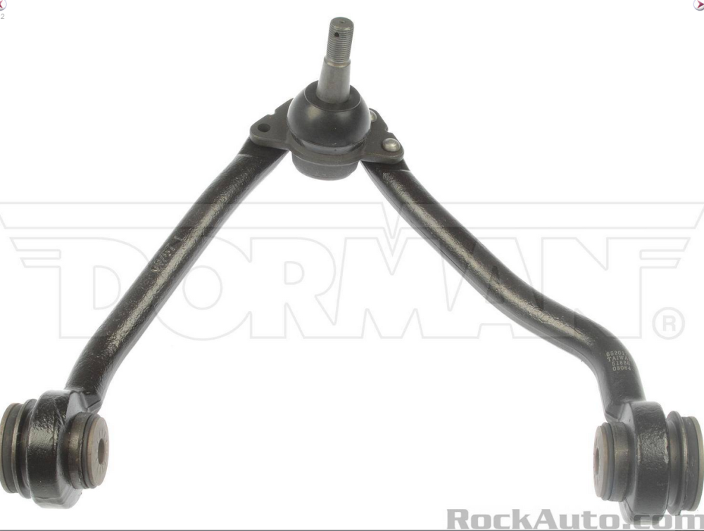

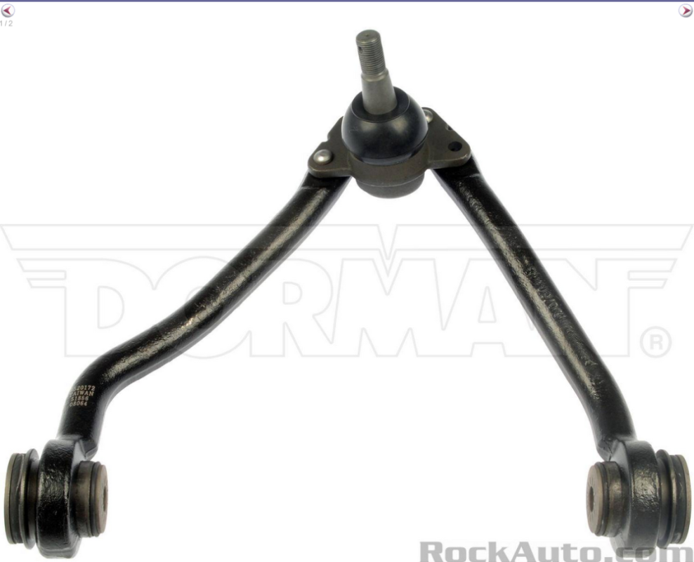

idk about C1500 ,2500 and 3500's but from left to right they are different. Here is a couple of pics to notate the bends on each. on each side of the truck, the 45deg bend almost at the bushing will be towards the rear. I did look on RA by application for a 97 model 1500, 2500 and 3500 and for "forged" uppers they list the same ones for all three trucks. the ball joints are different depending on GVW
Hope this helps answer your question. now as for the left fitting on the right side and vice versa and still being able to align. I would doubt it, I'm sure something would stick out like a sore thumb.
Left side....
Right side....

They are the same, they just flip the ball joint mount so it’s pointed downward with the 45 degree bend at the rear. Also, those are forged.
