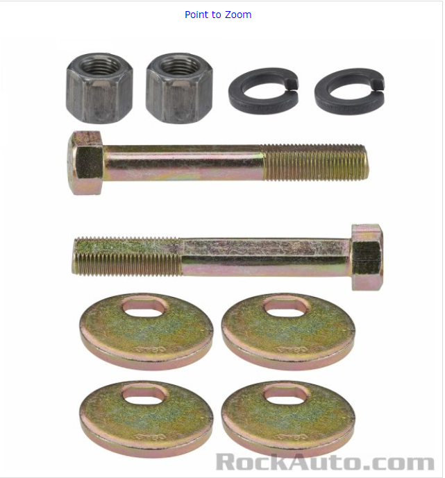

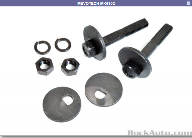

Upper Control Arm Bolt & Adjusters: 1 1/8 degrees vs 2.0 degrees?
Mevotech 2.0 degrees:
Moog 1 1/8 degrees:

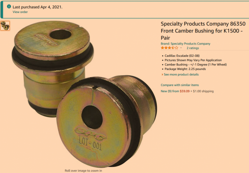

ah ok. these look like the OE ones on my truck. I had to buy some aftermatket offset bushing to install on the drivers side to get mine back in alignment. not sure what was up with the alignment but they had to max out the adjustment just to get it close with standard upper bushings. I installed the offset bushings and took it back and they were able to adjust it.
