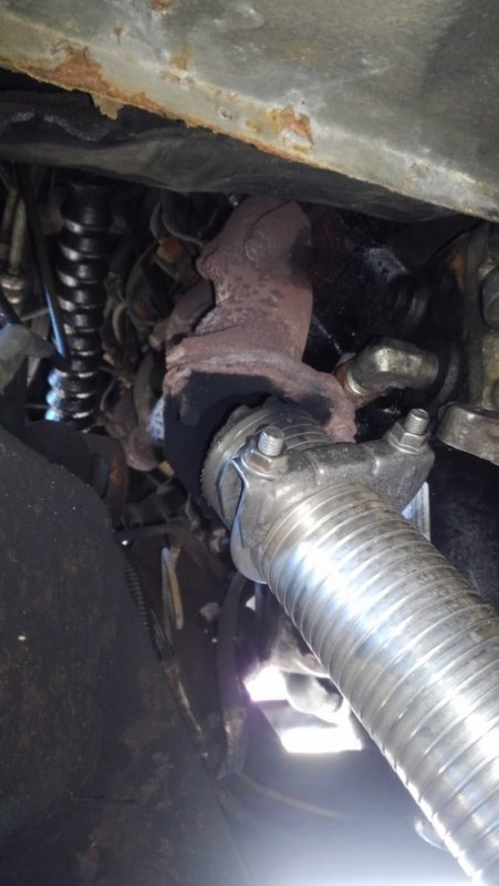

Shoot! I forgot to measure of the crossover pipe when I took the pic of my hideous repair. I was going to wrap a string around the pipe at the flange, mark it and measure the length. that will get you a close measurement just convert that measurement (circumference) to the diameter.
tighten the clamp a little tighter. or if you can still remove the flex pipe. grab ya some red rtv high heat silicone, coat it on the pipe where the clamp sits liberally and slide the flex back on. tighten the clamp you should see the flex get crushed down with the clamp.
WLKRP. (Well crap). I guess it’s try getting those flange nuts off and install the new crossover! I mean it’s not detrimental killer but the popo 👮‍♀️ might wanna follow you lol.
The only problem I see running it like that is the leak blowing on something that shouldn’t be hot like the oil filter or wires also you won’t be seeing any boost because it will all be going out that broken pipe
Due to circumstances from the past decisions I made involving situations between me and law enforcement most of them tend to not pull me over unless they absolutely have to..lol.. besides New York does not have emissions laws on older diesel trucks they can be as loud as they want
Do you have another crossover pipe to use? If so. I’d say go for trying to replace it if the nuts break use that flange repair you posted a photo of If not then for a short time wrapping that area good with something that can take the heat and be able to redirect what leaks downward away from the area and under the cab till you can get your hands on a crossover pipe
Yeah I have a crossover pipe to put on..got it from @ak diesel driver. I'm debating on just going ahead and trying to break those nuts loose by hand. I don't have torch's to get them really hot.
My concern is that from what I can see those clamps I posted pic of can't be used..one has to go around the manifold above the flange, and from what I can tell on these manifolds that area is square not round
The clamps of flange repair kit should fold open to allow you to get it over the pipe and manifold. I would snag one and try fitting it on there before breaking the nuts off. I’m thinking it would have to be rotated or clocked different so the holes are where you can get to them. I think the area where the studs go on the manifold will support the clamp even though the manifold is square
Valid point..if there big enough to go around the corners of the square pipe it should work....
