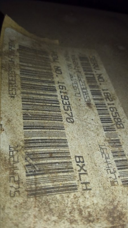

The only way to see if it has a tuned ECM is by taking it out from behind the glove box and do a visual inspection.
Usually the tuned ECM have a sticker on who actually provide the data inside the tune, unless the PO did it himself but to own one of those tool to put different tune is not cheap.

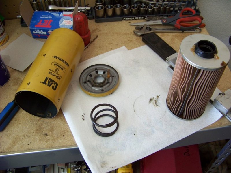

After wiping out a couple of Walbro's on bug infested fuel because I got tired of the big bowel screen plugging up and removed them ... Yes, no screen can ruin the lift pumps.
This is what I used for a filter before the lift pump: a CAT Water separator. It saved the injection system from bad fuel that destroyed the tank and injection system on my other 6.5 without this filter. In colder weather I would have added a heater to it.

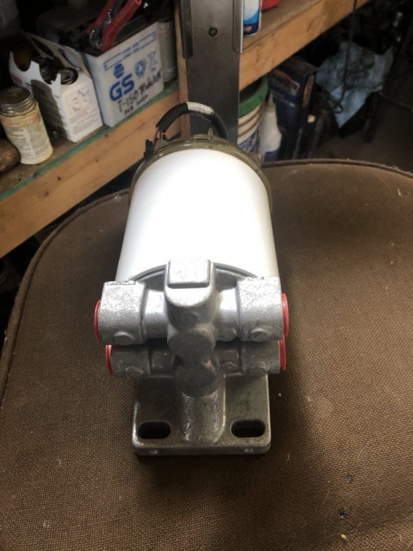

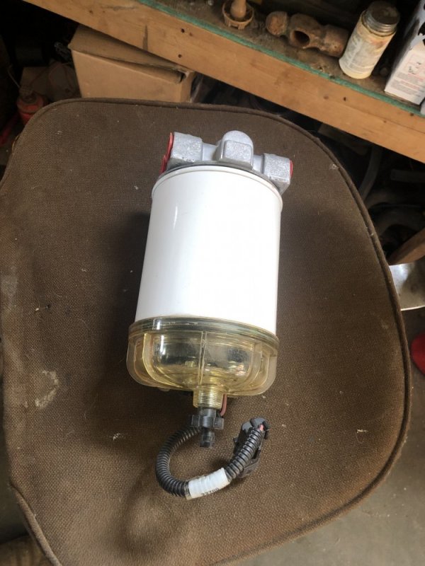

This is the one I have. Now looking it over a little, I see there is no air bleed on this unit. Must just crack the filter loose a couple of turns then let it fill.
would this be a good candidate for a pre filter ? At one time I checked with NAPA for the filters for this and they do have them available.

I was searching around last night for some kind of a heated water trap filter system. Seems the marine industry has them for about 50 bucks.
I dont know if a person discards the entire unit or if filters is a available for them ?

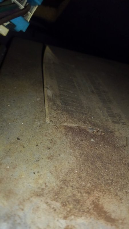

That's the sticker on top of the ECM.. not sure if they're supposed to be another one somewhere but that one looks like it got put over a different sticker.
