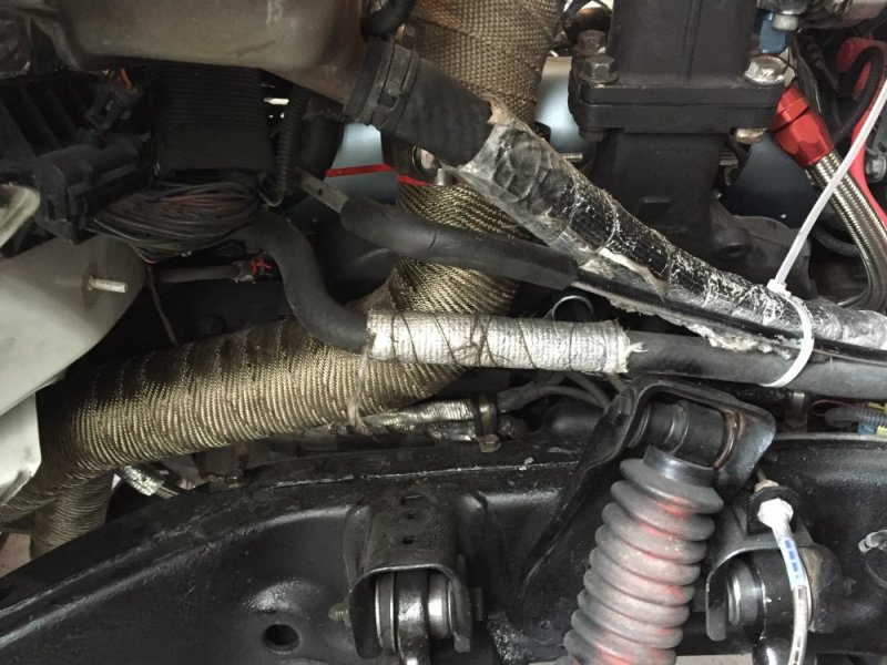

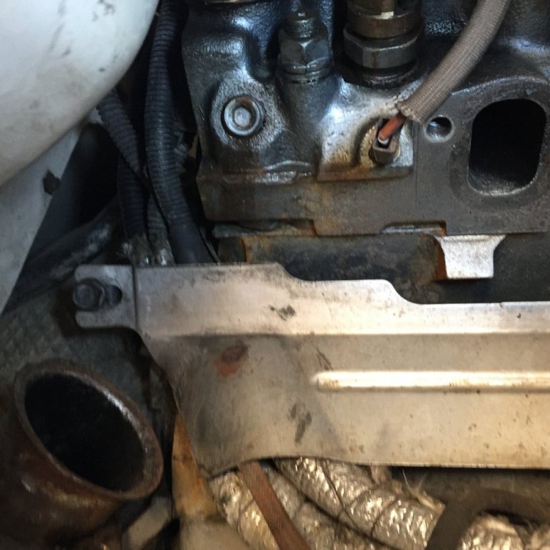

Pretty sure the #6 plug is blocked by the exhaust not #8. Can you tell if it's the same as the other plugs? Going with self limiting plugs means you need to absolutely know what all 8 plugs are before you increase glow time.
#8 requires a little agility to get too as it has the down pipe, exhaust manifold and the firewall all creating access challenges. The down pipe does sit in front of #6 making it a challenge too but, you can get to it with the inner fender removed. The heat shield tubes will challenge your ability to get the Glow Plug wires off #4 & #6 so use some long needle nosed pliers to remove them from the plugs and more so when you go to re-attach them.
Here's #8 without anything in the way. You can visualize where the Down Pipe and the exhaust manifold will give the challenge. My first go around (with SSD Insta-(Not so much) Heats) I got to it from underneath under the cab with a lot of "Army Speak" type words.
For Reference, Heat shield tube locations for 6 & 4 (right to left) on the exhaust manifold. Number 8's position can be approximated to the left.
Here's the exhaust all assembled (Fender and Inner Fender removed). You can see how the down pipe is in front of #6.20160528 3 Downpipe installed.JPG

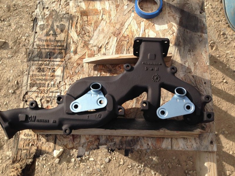

There were no heat shields on the manifold. I am pretty sure that I was looking at 2, 4, & 6 with the last one (8) not visible or touchable. I got the normal glow plugs, not the Insta-heats. I debated about trying to pull that fender well, but it looked like a super pain. It looks like the exhaust pipe and crossover pipe would have to move. Both of my exhaust manifolds should be replaced, but I don’t want to open a separate can of worms on a truck I drive 25 times a year, but need it to run & pull on those 25 trips. I ordered the PT Wiring glow plug harness, but I am looking at running it thru heat deflect tubing.

I am the king of cutting fingers, banging head on something, rust in eyes, etc. About the exhaust manifolds, any chance of being able of getting to them to replace via the same method. They are both rusty/rotted and the passenger side has been blowing by since I got it. I am already figuring none of the bolts will come out and I will have to try that weld-a-nut trick on the broken ends if I can get to them. The last thing I want to do is pull the engine. I will wear earplugs while driving first.

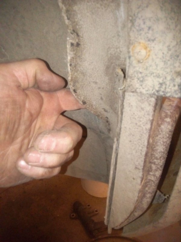

Well..., it got in the high 30s so I worked on the passenger side glow plugs. Super pain to get fender out, as I had to cut off 2 of the bolts that just spun. And I had to drop the exhaust pipe and loosen clamps all the way to rear of truck. Removing the glow plugs was the easiest part. One had boogered threads so I bought a tap (10 mm x 1.0) & ran them clean. I finally got everything installed & put back together with new plug wires for that side. It fired right up. I wanted to put the new plug wire on the driver’s side but it has some type of additional plug-in connector that I couldn’t figure out where it attaches. It’s up by the glow plug relay terminal, but the wires on it now don’t have it. I am not asking for single digit temps, but I am curious how it will do.

I've never had to go through that much hassle to change the #6 & #8 glow plugs. I just put it up on tall jackstands, then go underneath and reach up backwards to get to #8 to remove/replace it using a deep 1/4" drive socket for enough clearance to the exhaust manifold. For #6 I remove the fiber splash shield from the inner fender and go in through there with a long extension with a universal on the end and a deep socket.
