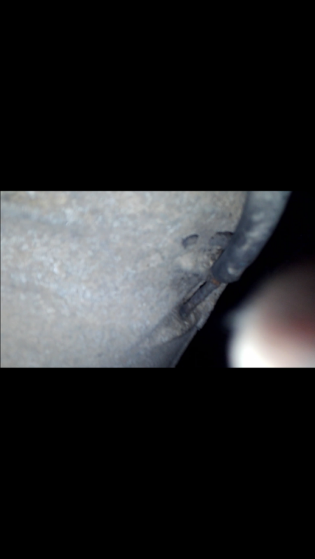

Then I happen to notice that the little Black box on the driver side of the tranny that the linkage hooks to was covered in fluid the whole tranny looks nasty as hell right there... There's two electrical plugs that go into it... That was soaked in fluid so I started trying to figure out where the fluid was coming from... That didn't take long.. there is a little rubber hose inside diameter is less than a quarter of an inch that comes off the top of the transmission I got my camera up in there to snap a picture of it and evidently it's a little middle nipple that comes out the top that the hose hooks to..the hose came down the side of the transmission and was dripping fluid right on that box...the other end of the hose looks like it was broke off from somewhere but I don't know where it goes or if it's supposed to be some kind of vent or something.. anyway I routed it down the other side of the tranny for now till I figure that out and I took brake cleaner to the side where the electric control boxes and cleaned it all up... So my questions are what is that hose is it supposed to be connected to anything at the other end and what are the two plugs on that control box..could be my imagination but it seems like the truck is running better and shifting better since I cleaned it up.. like I said I took a pic of the top of the transmission where that hose hooks into.Screenshot_20210405-202116.png
Try taking a pic with phone turned sideways.
Maybe a little farther away too.
If that is the vent... why would anyone put a hose on it except for driving the truck into deep water. Hut if thats the case the hose should go up higher to keep water from getting in. A hose going downward makes it worse.

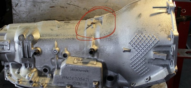

Then- it is a vent tube. Fluid should not be coming out unless the transmission is overfilled.
Circled vent tube -which on your truck should have NO RUBBER HOSE.17B0FF10-F4BC-4EB6-A094-B37108032099.jpeg
Ok that's weird..the circled one in your pic is in fact the one I'm referring to best I can tell..but tranny isn't overfilled..I'll check again in morning to be sure..I can't imagine that control box effecting much just by degreasing it but who knows, maybe fluid been getting into the electrical plugs, and effecing shifting..it has felt for awhile like the truck is taking off in second gear, like it's bogging out kinda like taking off in second with a manual is best I can explain it.. maybe fluid in plugs is preventing proper up and down shift..

Trans, diff, t-case, p/s pump cap, hydro-boost, some vacuum vents should have a hose up high into the engine bay (bonnet), depending what the vehicle is used for dictates what you use at the top most portion of that vent hose.
As Will L mentioned fording (aka: water crossings) needs be up high, sandy environments require a "filter" like a fuel filter for obvious reasons.
P/S filler can be extended by using silicone hose, I cut off the fill port on an ole p/s pump and use a hose w/same diameter to extend the filler cap up high and use vent hose too.
Have a snorkel, then that is the best place to run those vents"up high".
Be thankful GM places the trans vent on top of the case, DODGE TF trans are vented at the trans pump, in this case I thread and plug the Torque Flight pump then tap the case at the top to run a vent hose up high...
