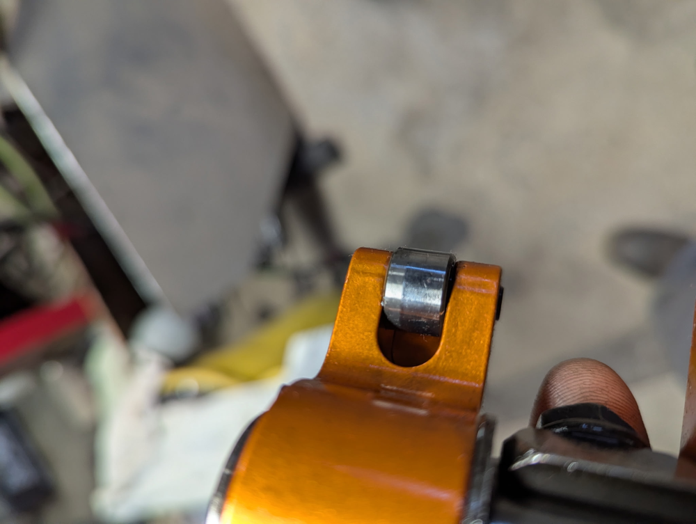

This was the only HS roller that had any kind of wear marking whatsoever. It's not flat and spins freely - just like all of the rest of the rollers. These have about 20k on them. Going to go ahead and put these back in.
