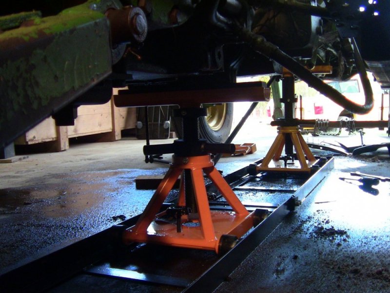

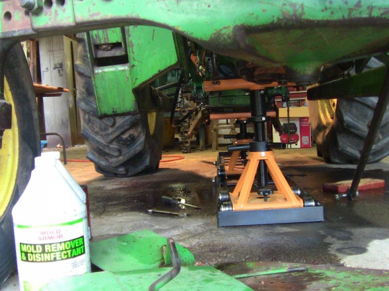

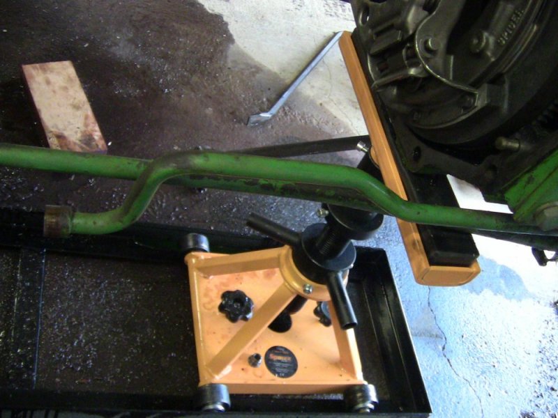

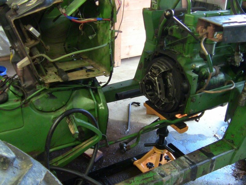

Well, the stand I bought worked very well, smooth and easy to roll apart, so far so good, I will attempt to put it back together today.
All the new parts I purchased were wrong except the clutch disc, go figure.... I did get lucky with the disc, I went for a 6 pad ceramic button disc, they lock harder than the full disc's do so they say...

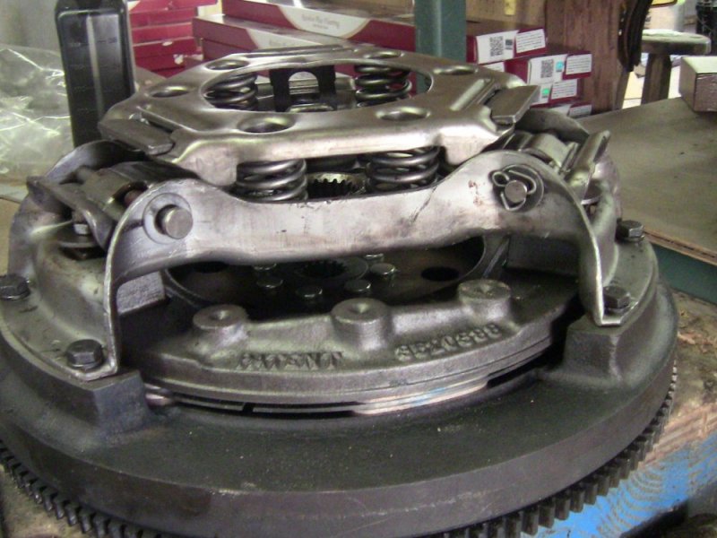

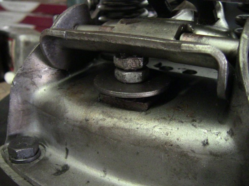

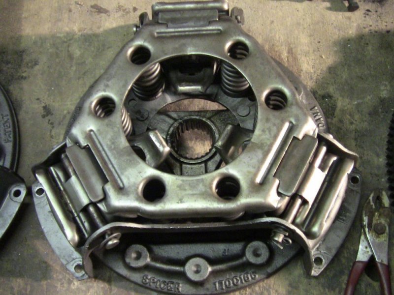

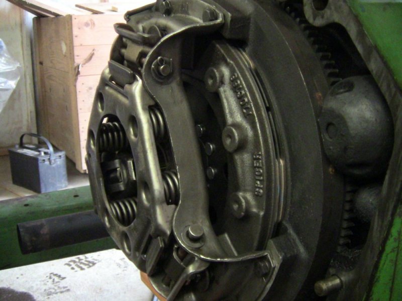

I found the trouble with the pressure plate that was in it, these MUST be adjusted anytime they are removed or replaced, the fingers are adjustable and a measuring tool is needed, I also bought one of them..
When I got the tractor split apart I had a look at the pressure plate and it was sitting lopsided, the fingers were no where close to even or where they should be.. back when I had it replaced I'm guessing the fella didn't know how or what to do, thus the clutch never locked up hard, the finger adjustment has everything to do with the clamping force on the disc..
Now if I can get it all back together without breaking something or bending the disc LOL.. that's the tough part of the job...

I have heard of adjustable ones, but don’t remember ever having done one on anything.
Please show how thats done once you get tool and such, be interested to see how that works.
way cool set up to split the tractor and use the angle iron rig like mini tracks. Are those knobs in the jack stand part for locking the axles to not roll or are the tilt adjustment?
