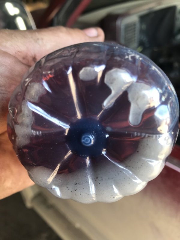

This spring it smoked grey for a second then would clear up, it started to buck at certain speeds but would run perfect at others, I suspected the APP, changed out with no luck. It started to get much worse so I thought maybe bad fuel or a plugged filter. I opened the water drain and got a bunch of wax out of it, likely Biodiesel.

No, but there is a good flow, in case anyone wonders, the black specks on the bottle are likely welding dust off my table.

That looked like water mixed in to me. The wax is paraffin trying to mix back in. When the paraffin count is high the slightest amount of water absorbs into it. This keeps the paraffin at a thicker level than the rest and it cant blend like it normally does.
When there is no water present (really rare since alcohols are in all of it now) the wax is slightly yellow.
This presence of wax can be tested by separating the white stuff from the fuel, then in a closed container so no evaporation can occur, let it settle a couple days. Then put in the freezer a couple days. When it comes out there would be ice formed separately from basically candle wax. In refining the plastics to fuel, my friend Jason and I called it cancer candles. If instead of freezing it, you separate the white stuff from the fuel and get it to light on fire (takes some effort) it will burn a long time with a descent amount of smoke. If you can not get it to light even with a torch, it is just water emulsified into the fuel.
This is one of the times it may be good to bypass the tank and filter, use a 1 gallon gas tank with some fresh diesel and 911 at highest ratio and have it just feed the ip directly. Burn about 1/8 gallon just idle and revving engine.
The wax can coat components and mess with them. I doubt this would “fix” the issues you are having, but it may be contributing. Getting any water trapped in the ip out of there could be a good thing.
Then do it again but instead of 911 mixed in, use ATF mixed in. This will “wash” it clean with the petroleum detergents, and is a good lube.
If you want to rig a long hose and a spare lift pump from the bed of the truck and actually drive it you could, just use caution about allowing the line to suck air.
I have fuel conditioner, ATF and antigell in my fuel right now. When I use the water drain I no longer get that crap in my sample, I don't doubt the IP is gummed up. The inlet screen was clean, I thought it would be plugged off.
