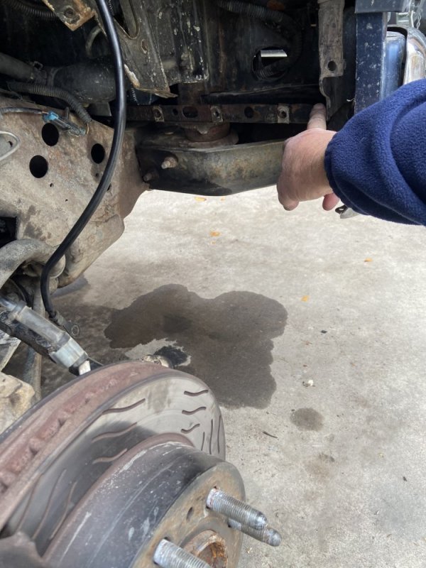

After resealing the passenger side valve cover, I was putting the heat shield back on and had the two little sheet metal screws sitting on top of the battery. Of course I knocked them off. I found one of them below in the shelf/tray inside the fender well:

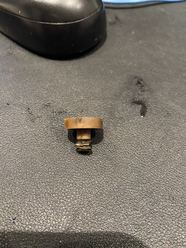

While searching there, I found one of those plastic valve rocket retainers, pointed end down sitting in a hole. It seem highly improbable that I knocked one off and it flew over there, dropping down the front side of the battery landing pointed side down in that tray, but I can’t take the risk.
I have all the injector lines connected at the IP and the injectors, but the intake manifolds are off. I need to go backwards here and pull the valve cover again. I ordered a set of 8 valve retainers delivered to O’Reilly’s in Missoula by Thursday. This was the cheapest way to get all 8 retainers (RA only had 6). I had previously replaced these on the driver’s side when I was re-sealing that valve cover about 12K miles and a couple years back.

I think there is very little chance that I knocked a retainer off AND it landed where I'm pointing in the picture. That said, can't risk it. Parts will be here Thursday. I can have it back together pretty quickly.
yeah. It looks to be quite dry of oil, in the picture. But, does not look like a lot of road grime on it too.
I thought maybe it fell down in there from when You did the other side.
If You still have the old buttons from the LH side, count them up and see.

Do not have the old retainers from the other side. I ordered 8 new ones which will arrive Thursday. Not going to take chances on this, so I will replace all of them.
