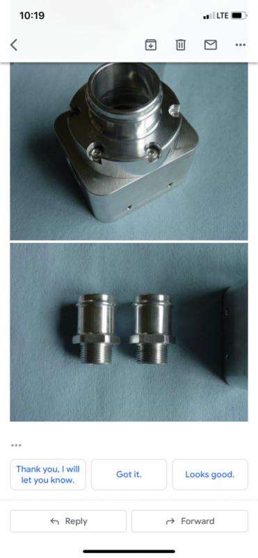

So if someone is looking for an option of single stat closing blockoff, but need the rare 96 or hard to fit around throttle, etc.

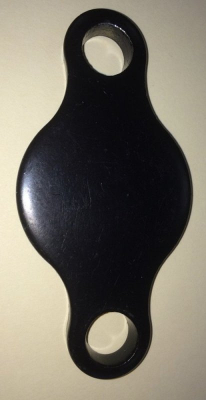

You need to start with 2 of the rearblock off plates like the black painted one in the pic. Drill and Weld a 1” barb fitting to them so a 1” hose can attach. Don’t use the Factory threaded ones, they only have openings for 1/2” npt.

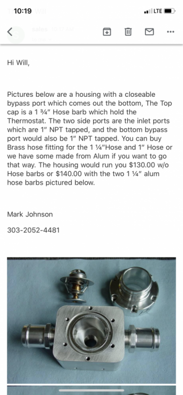

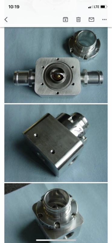

Next you need to drop about $140 on this bad boy
It has 1” npt inlet- one each of the two sides, and one on bottom that is return to water pump. Then the hose fitting on top is 1.75” for the upper radiator hose. If ya need a temp sensor in there- add a “T” where you want it. And if those exact sizes don’t work, like you need 1.5” radiator hose on top- don’t worry. These guys make it all to order. If ya need something they don’t stock on the shelf- they will custom make it. You need tomake a bracket to mount it.

Here is the link to the company, IPSCO. And a wazoo thanks to @n8in8or for finding this company! Man, Nate- you sure inspire us to spend money and make trucks better!
This is basically the same as the factory single block off thermostat crossover.
For many people this would be not needed because they can easily fir the single stat block off thermostat unit, but if someone needs the rare 96 and cant find it. Or especially van/ hummers with the ridiculous huge and in the way intake they use.
Imagine your thermostat crossover, but cut out the aluminum tubes that go from the housing down to each head and replace them with heater hose. A person would be into this set up $130 plus three of the 1” nipples. They qouted me $10 for two 1.25” aluminum nipples (better to keep aluminum or brass, dont screw steel into aluminum) so imagine that 1” is the same. So $145 and needing to alter two block off plates that are abundantly found or just made from scrap steel.
The rare 96 I just found on ebay has some damage but is repairable. It is $200 before shipping. First one I have seen for sale checking about weekly for 6-7 months.
Finding a perfect condition crossover can still be done and possibly be cheaper. But as time goes on that will get much harder. With this as an option- no panic. And looking how well this is made- awesome!
